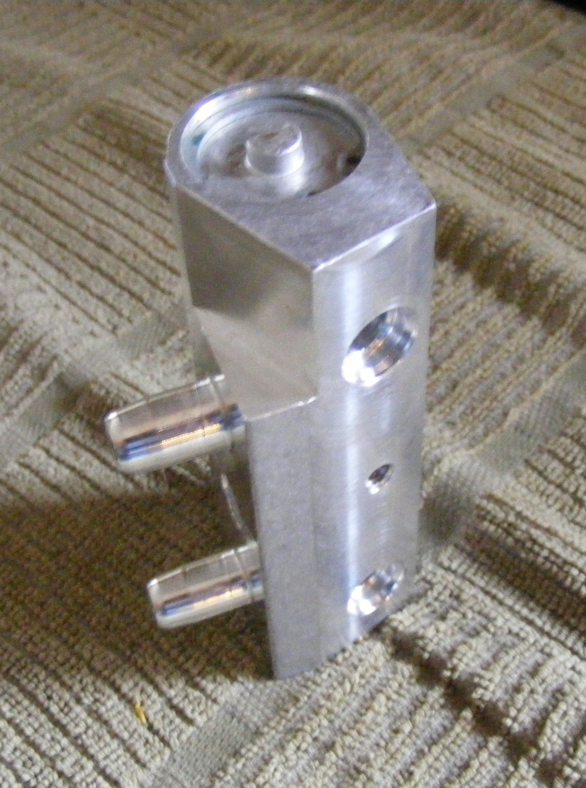

Yes. I bought a replacement thermostat and altered the internals. It will be swapped for the factory is Friday. There are two YouTube videos on this modification. They both work fine. I did the part shuffle. You have to assure that the window in the bobbin aligns with the port to get full flow. I'll have a spare if it isn't to my pleasure.
Swapped transmission thermostats today at Deegan's. Pretty straight forward. Mine did not have the screw in clips for the lines but a 'crows foot' plate and it only goes on one way. A little grease was needed to reseat the lines. The single central unit attachment bolt was finger tight! Torque spec is 182 in/lb. The crows foot just nice and snug.
It is in the 30's (F) here today and the truck was already warm from the 18 mile drive to the shop so I still haven't an idea how quickly it will warm up...but...peak temperature was a surprise even for 37F ambient. At 55 mph over hill and dale for a hour it ran between 125 and 130 F. An easy pass through the lower four gears got it to 141 F and then cooled right back down. That is colder than I thought it would go by quite a bit. Don't expect this on yours unless your running the same 170 F coolant thermostat. Oil peaked at 188 F on the hot side. It's pretty close to warmer weather so I'm going to take a wait and see if this will be enough on hot days and I'm sure it will be but.... This is still warm enough to trip the set points for the transmission and AFM. Everything works just fine. It ran cooler than that on 0 F days without a cooler.
Seriously I had thought it would be over 160 F and I'd still like to see that temperature routinely. But that isn't going to happen with the factory unit in any configuration I can dream up. The factory unit in the open position still bypasses too much fluid around the cooler and restricts what does go to the cooler. Aftermarket units have a built in 10% or so bleed in the closed position. I had anticipated that there might be need for a second stage cooler with it's own thermostat for addition cooling but as it looks now that thermostat may be better placed between the pump and cooler. Warm weather will make that choice. IF one is installed it will be a 160F unit. Time will tell.
FYI the top line on the thermostat is the out and goes to the bottom of the radiator tank mounted cooler. From the top of the cooler to the bottom of the thermostat. Now you know.

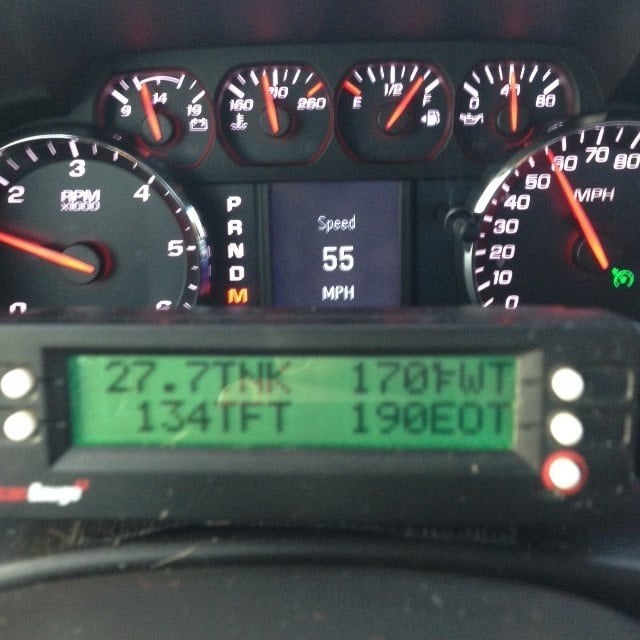

I did not count on the crazy radiator efficiency of this truck. I have a measured 40 degree F spread hot to cold on the water side and what you read in the photo on the oil side.
The photo is 3.5 hours into a 4 hour 200 mile trip today that ended at 28.0 mpg. Trip speed average was 48 mph with the highest speed driven 55 mph. Ambient air temperature peak was 52 F with a low of 48 F. 20 mph wind split equal against and assist. 25.9 mpg into it and 30.1 with it. Most of this trip is Interstate. Federal and State highway most of the rest and about 5% city. I can bump the trans temp to the low 140's on an on ramp or in town but it recovers quickly. Warmer temperatures will moderate the radiator efficiency. I just don't know how much yet. It shifts sweet.
You may have noticed I've had 1/2 the grill covered all winter and it still isn't enough! It was right at freezing today when I left for the horizon. First time with the cooler modification from dead cold. Took 9 miles for the water to come to heat. The trans and oil were pretty close to stable in that same period of time. No comparison to the unmodified version though as it just doesn't get that warm.
The Jet 170 radiator thermostat will modulate to a stead 168 F at 50 mph and 170 at 55 F. Below 50 mph it vacillates around 172 F +2F / - 4F.
