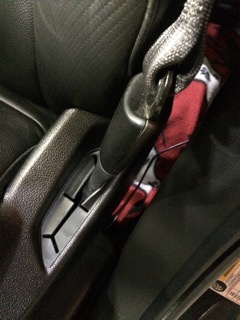

So. I had the seat belt tensioner recall done yesterday. What a piece of crap fix that GM has come up with. Their solution is to cut the rubber away from the belt and fix the tensioner at the base. They sent the dealers a template to cut the rubber. So now I have the driver's side seatbelt with a "hole" where it comes out and the passenger side is left alone.
I'm wondering why left side is faulty and not the right as well.
The dealer has no other fix to make it look good.
So I called GM customer care in Oshawa and they are "looking into this".
Not sure if anyone else is unhappy about this fix, but on a $60 k truck GM had better come up with something better. Really adds to the resale value.
See pictures attached. Before and after.post-126105-0-56397200-1482290220.jpegpost-126105-0-00484900-1482290235.jpeg
