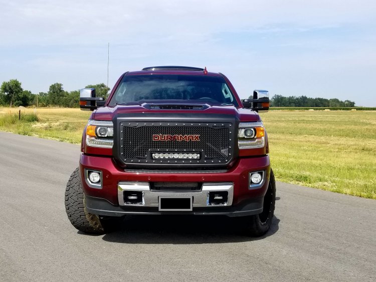

Instead of putting lights behind your OEM grille, you can get a Royalty Core RC1X grille that includes a 20" light bar from VisionX.  www.royaltycore.com .  The light is forward of the active shutter system!

What other recommendations do you all have for adding lights without removing the shutter system? I've looked at removing just the bottom row or shutters and mounting like a single row 10" or 12" bar possibly on each side of the servo. Thoughts/concerns there?
5a4c211f61e8c_GMCHDRC1XDuramax.thumb.jpg.1ca5bbb7bdf67887df76efd9102a8e1e.jpgThat grille and light combo from Royalty Core sit in front of the active shutter system

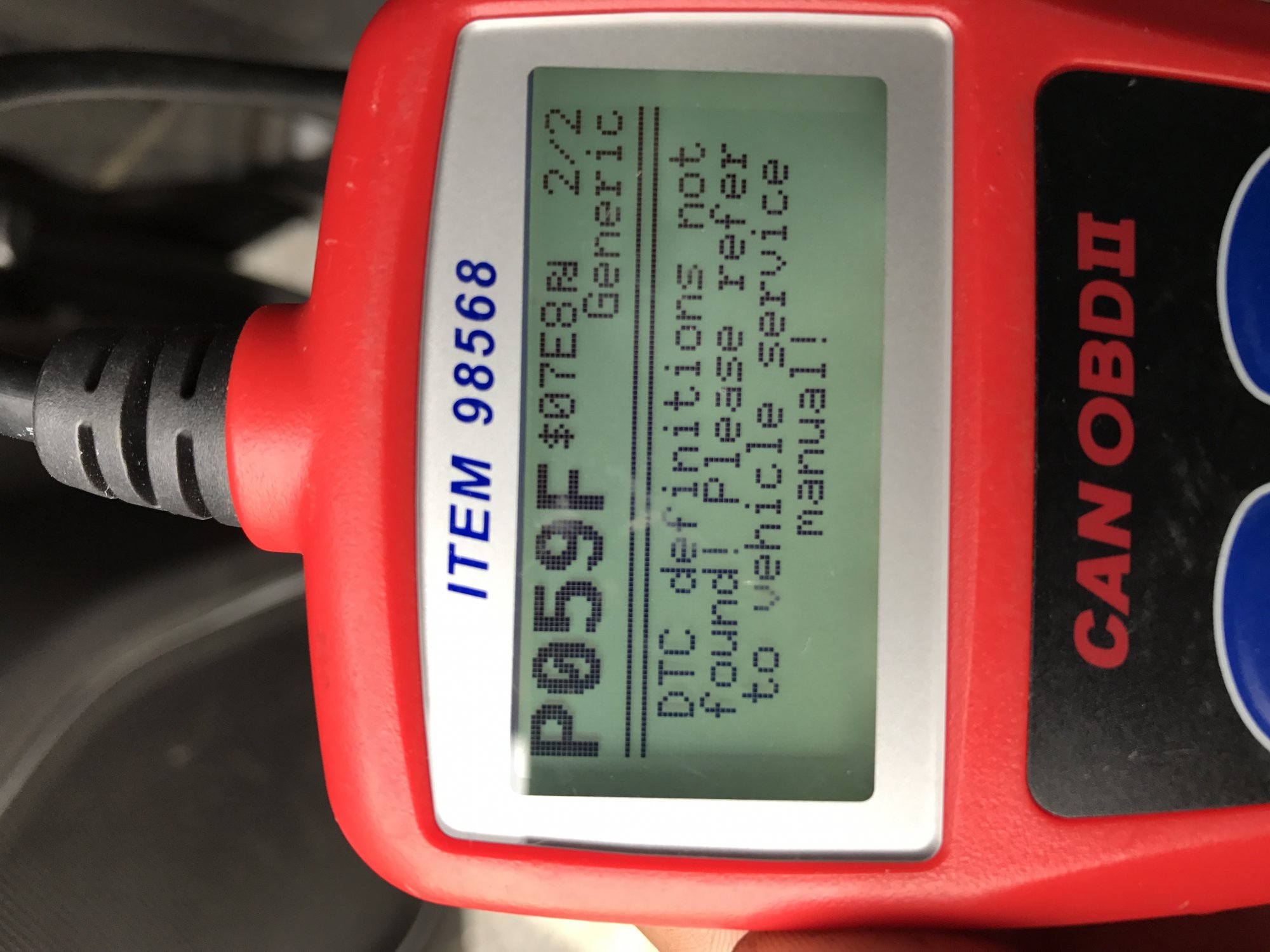

So I did the mod to the servo and now I'm getting another light. It was good for a few days!! What a pain this is. See pics below
Did you end up finding out what that code was for?
Sent from my SAMSUNG-SM-G935A using Tapatalk
Had the same problem. After some time the motor out powers the plastic stops for the shutters and will just keep spinning and throw the code since it doesn't read it opening and closing correctly. I fixed it by buying a new shutter system which sucked. This mod is not worth it because the new shutters will set you back another $300 and you have to get rid of your light bar that's already paid for
