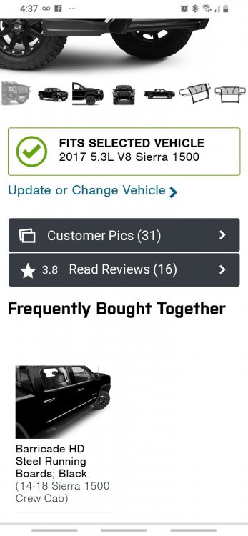

I bought a Grille Guard Barrier from American Trucks because their site said it would fit. It doesn't! No refunds! Scammed again! Can air shutters be removed? If so, how much will this effect the performance of 2017 GMC Sierra 1500?

Yes you can remove, and yes like posted above you will get a CEL.
You will not loose any engine performance if they are not there:
