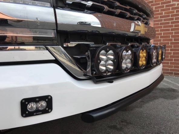

I saw this on the Baja design instagram page but this would have to be a custom build???
