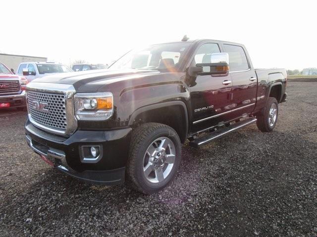

Hey guys. New GM owner. Found a 16' 2500 denali for 46k that i couldnt pass up.

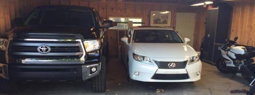

Looking for some advice. My last truck was a 15' Tundra. I put a 3/1 level kit on it with 20's and 33's and liked it (photos attached). I like the look of this setup.

I'm looking to level the 2500 and fit 20 or 22's with 35 tires on them.
I want a comfortable ride .. nothing stiff or hard bouncy. I like comfort. I don't do any off roadin'.
What would you guys suggest for me? a level or a 3-4" lift? I've read levels on these 2500's make them drive harder.
I'd like to fit 22's with 35's in there. What's the minimum lift i need to run that setup?

If I'm right that truck has magnetic ride. Not good for your suspension mods. :happysad:

I do not think the 2500HD Denali's got the MRC system. Just the half tons.

HD's don't have magnetic ride control.

You are not going to improve the ride on an HD truck, all you can do is play with tire pressures to help.
Here is a 2015.5 Denali HD with 35's on factory wheels and no lift. He just turned the bars up a bit just to remove some of the rake. http://www.duramaxforum.com/forum/build-threads/852162-lyles-15-5-denali-3.html
The only thing you can do to improve the ride is upgrade the shocks. I Highly recommend Bilstein 5100s. They ride much nicer than either of the shocks you might have from the factory. Several people have gotten 35s on with just a level, but cranking the front of the truck up that far is going to ruin the ride, screw up your CV angles and put a ton of stress on your steering gear. If money is really no object, I'd go with a small lift.

I would go with the lift 3-4 is perfect and it should improve the ride a bit but you shouldn't make it worse with a good lift, I put a leveling kit on, new keys and shock extensions. If I could have afforded the lift I would have done that but I could not live with the low front end. This summer it's a lift, BDS makes the best in my opinion. You can do the same cranking the bolts but the kit is designed to keep the geometry correct, I would go 4 on the lift. Nothing makes these trucks look better than a lift, tires and rims, that's why I bought this truck, I know what it can be some day.
Your truck will clear 35's easily with just a couple inches of lift. However, you may not like the ride. I would recommend going with a true 4" kit and cranking it down to the 3.5" range for a soft(er) ride. I think you'll probably be happiest with that. Leveling kits reduce the ride quality, unless you go all-out and add the UCA's, better (and longer) shocks, differential spacers, etc. And by the time you do all of that, you'll be within a few hundred bucks of a true lift kit. If you've got the money, you might as well do it right the first time.
