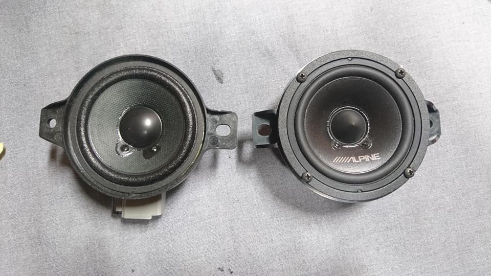

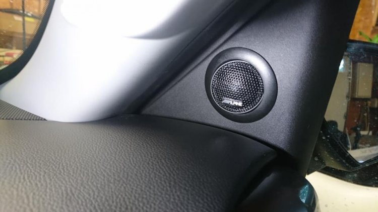

I like the custom tweeter mounts, do they allow you to mount the tweets off axis? I ask because I have installed some HERTZ HSK's using the stock location and they sound horrible, I have to have the balance 3/4 to the right or the passenger speaker is mute. I would like to mount them off axis however I have yet to find a good mount / bracket

Those things are beautiful. I tried countless calls and emails to Alpine but customer service would always refer me to parts and parts would never email me back so I don't think they're selling it standalone.

Very easy to make tweeter mounts for stock location using the factory speakers. Factory dash speaker has plastic frame. Just cut the cone away webbing away leaving the flat frame. I cut a lite weight metal washer from sheet metal to use as a spacer when I tried a set of Alpine tweeters in the dash. As has been reported on here prior, having just a tweeter at the dash, cut off it soo high, mids get lost. Seems you need to be somewhere about 500hz and up at the dash location.
The tweeters cannot be adjusted in the alpine pod. Basically there are two slots on the tweeter part of the pod and the tweeters just twist in

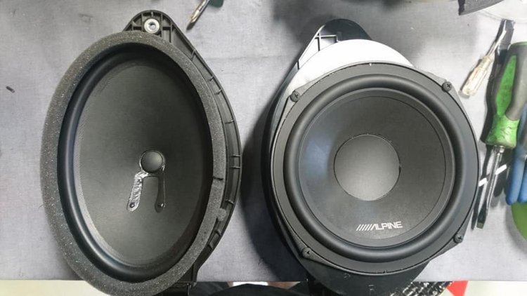

for the most part.  I found the 8'' midbass speakers and 3'' mids with crossovers for both on ebay for a really good price.  I used some regular S series tweeters with them since the specs are pretty close.  I'm only running them off of the stock head unit with the passive crossovers they came with and they sound ok. not a lot of bass. I feel the 8'' need way more power to really shine.  I'm planning on a DSP with active crossovers soon, it should really wake them up.  alpinetruck1.thumb.jpg.d0bc806daa9b99eff8fc57d92c5debfe.jpg
