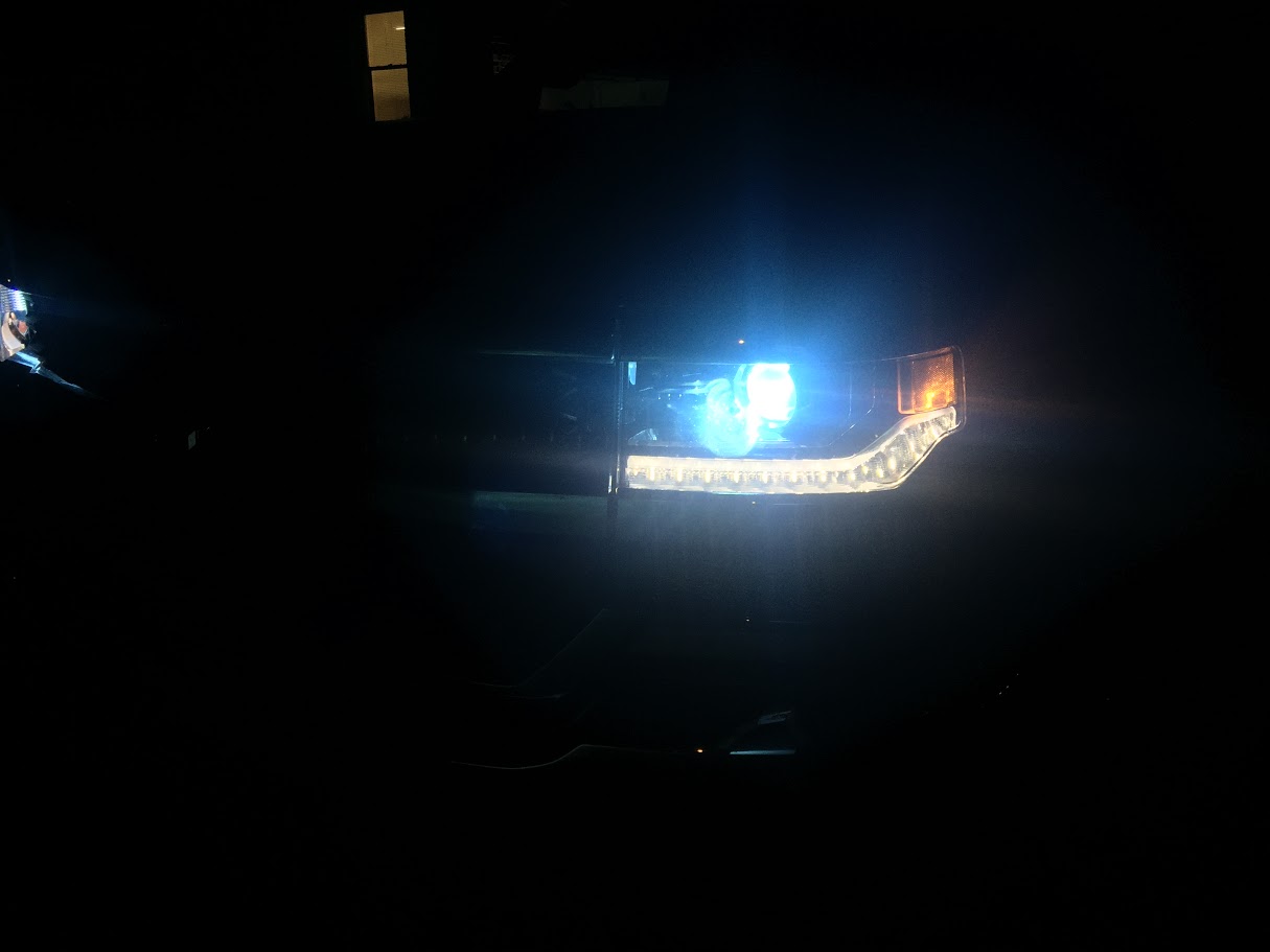

Any photo of the truck. I want to see how much blue they show off compared to the white led
I will grab a shot later this eve to see if I can show the comparison well.
  • Replies 272
Here ya go!!!
Right at the initial turn on (bluest output time)
60 seconds after initial turn on

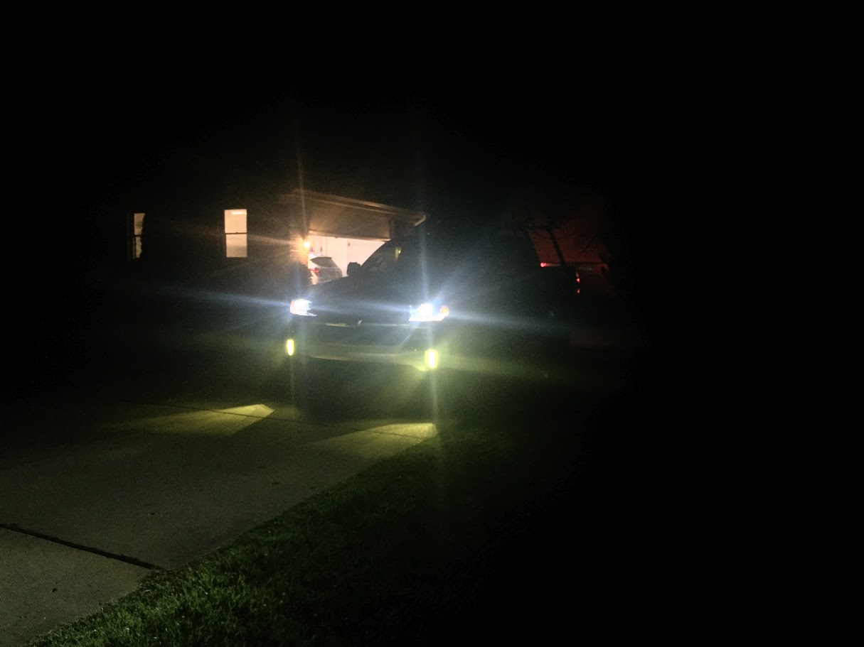

Low Beams
High beams
Fog Lamps Only
Low Beams and Fogs
Front Shot
How did you get the fog lights yellow, is it a yellow film you out overtop the light?
Foglamps are just a Lamin-X film. No hardware changes.

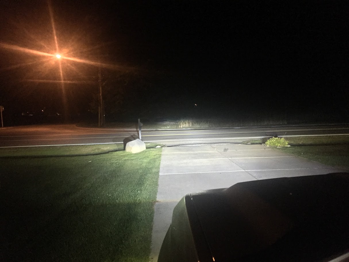

I just got a couple pictures while on the road this evening. Not the best but they give an idea.
8a5acef5ebdef12bd75450ab4c29ad87.jpg4218475ff23be74f9f32fb7f7c832881.jpgf03fe2e11581c3bebf7c41e54d6d29b8.jpg
Note I have the Morimoto led fogs on too in this one
Off in this one
