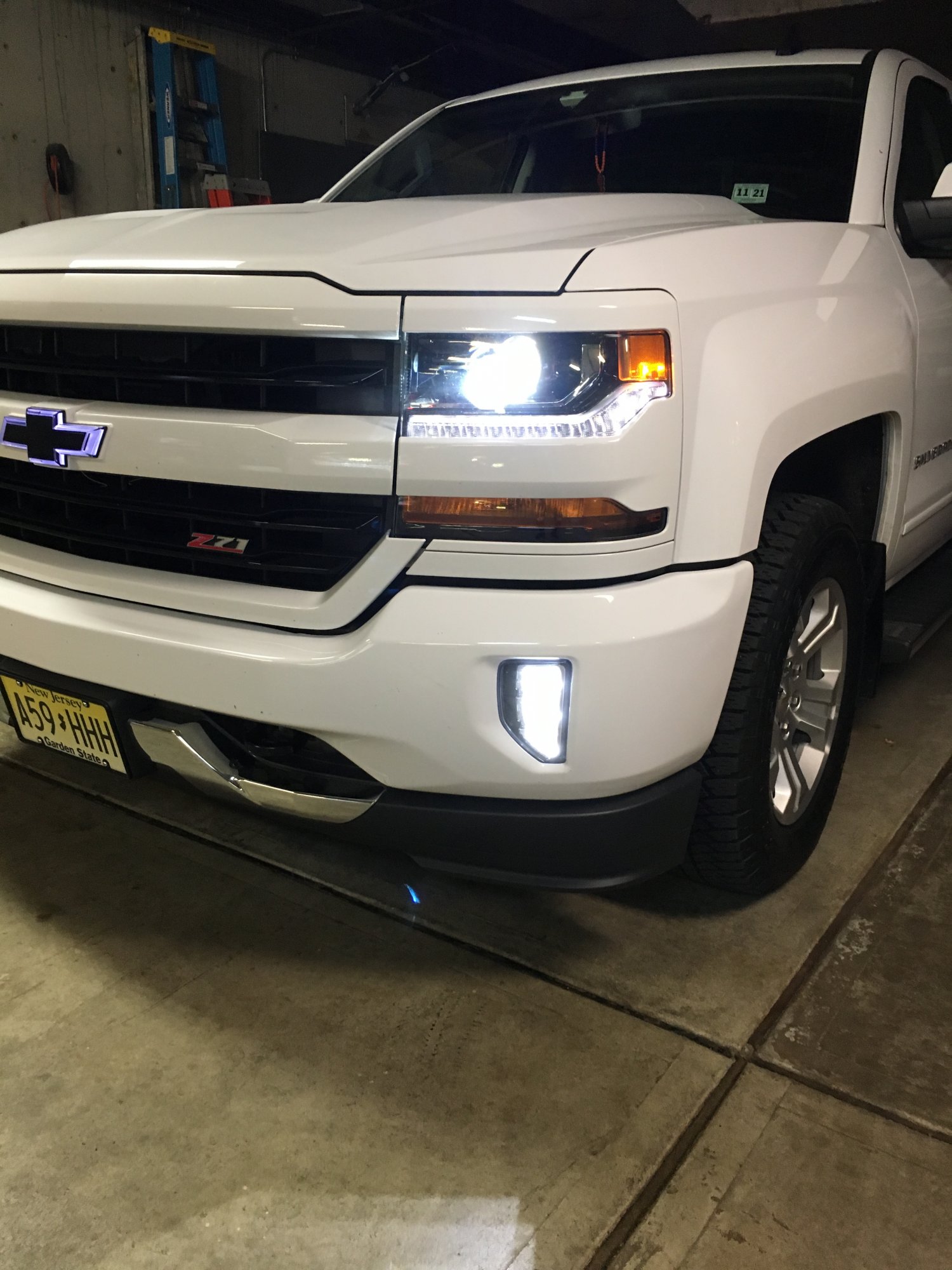

I received an inquiry about how the bulbs match the LED fog lights with the Z71 package.  I did my best with iPhone pictures, see for yourself.  In my eyes, in reality, it is a close match, but if you want perfection, you may want to get 6500K for more blue as the LED fogs are very blue.  See attached pics.  Again, my bulbs are 5500K as I just wanted the most light output.

I'm still on the fence about color.  I'm really not looking for anything blue but more of a pure intense white. Certainly no yellow!  I'm having trouble guaging the output of the each of the bulbs from the pictures on this thread though.  In some pictures by Limited360 the 6500k bulbs look way bluer than the led DLR strip and the fog lights appear to be yellow in contrast.  Also, MrElusive mentioned that the 5500k are not as white in real life as the pics.  The ground output pics all look the same (really good in fact) and the housing pics look so different.  I know it's simply due to camera settings etc.  I guess I'm just trying to get a definitive answer on how accurately morimoto rated the color of these bulbs.  Is the 5500k truly pure white with no yellow?  Is the 6500k noticably blue?

The 5500k are pretty white to me. The stock bulbs are not even yellow.

1) I have yellow film over my foglamps, so they are truly yellow in the photo's
2) The pictures with the super blue are bulb at initial turn on during warm up, the 5500k at this point in time would also be blue (stock ones can show this even)
3) Once up and warm the 6500k does not have any blue to it in my opion
4)  From TRS: 5500K: Pure White (~3400 lm) / 6500K: Cool White (~3200 lm)

From what you described I would guess you are more after the 5500k bulb.
