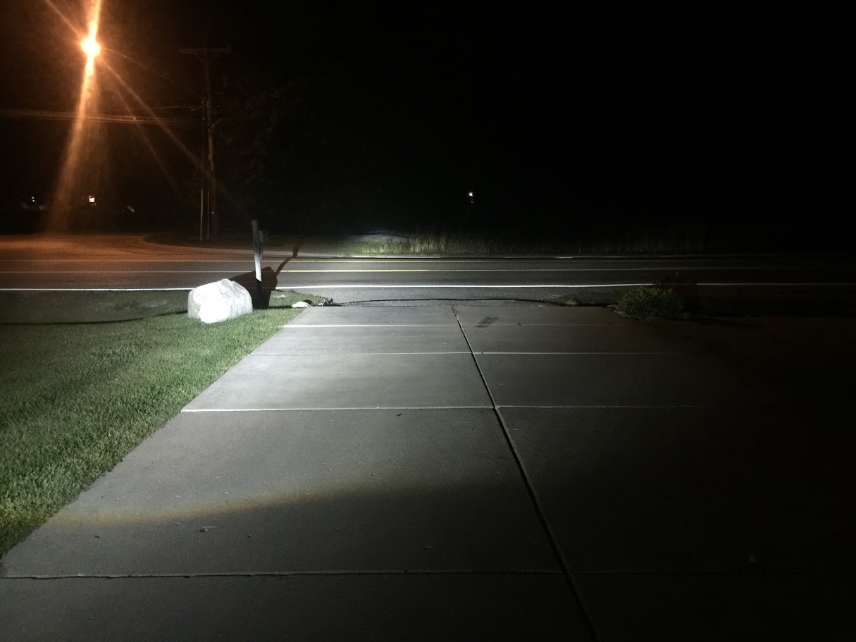

Not the best pictures by anymeans, the SLR wouldn't turn on and the wife was long gone to bed (not my camera to mess with).. So I used my iphone which do no justice for these.
This is the OEM Only
This is the Morimoto Only
This is the Morimoto on the left, OEM on right of photo
Both Morimoto now
Keep in mind this is also an OEM Kelvin compared to a 6500k which should yield lower output, but being 35w it still blows the 25w away!

Thank you for the Pics and feedback!!
Anytime! I need to double check alignment and then get some on the road pics! Towing the camper they were high, don't want to blind anyone with these things...
Also I will get some high beam photo's. Just wish they would of came with 35w from the factory, so silly.
