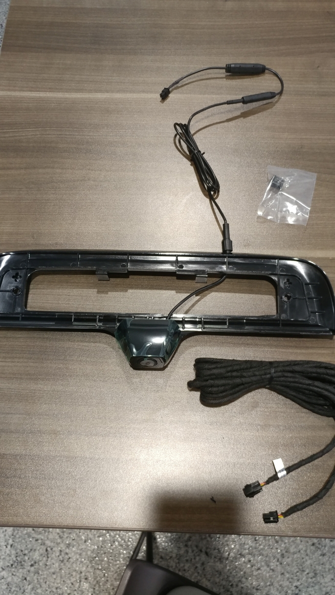

Here are photos of the Silverado Cargo Light camera...Was $159.20. Will post more photos soon.
The cargo camera plugs into the Echomaster setup in the 4th camera input on the controller box of the Intellihauler module. Two cameras are the mirrors, one camera is the wireless camera, and there is a 4th input that this can plug into.
Hmmm. I was wondering about the price being so low. I see now that this camera is not the one that is integrated into the third brake light. I will be interested to see an actual view from this camera when you get it installed...
Per Echomaster, the photo of the fully integrated light that was part of the actual lens was a prototype. This is the model that made it to production, so the "lens" model is not even available. Once I get things hooked up all around, will post many more pictures.
