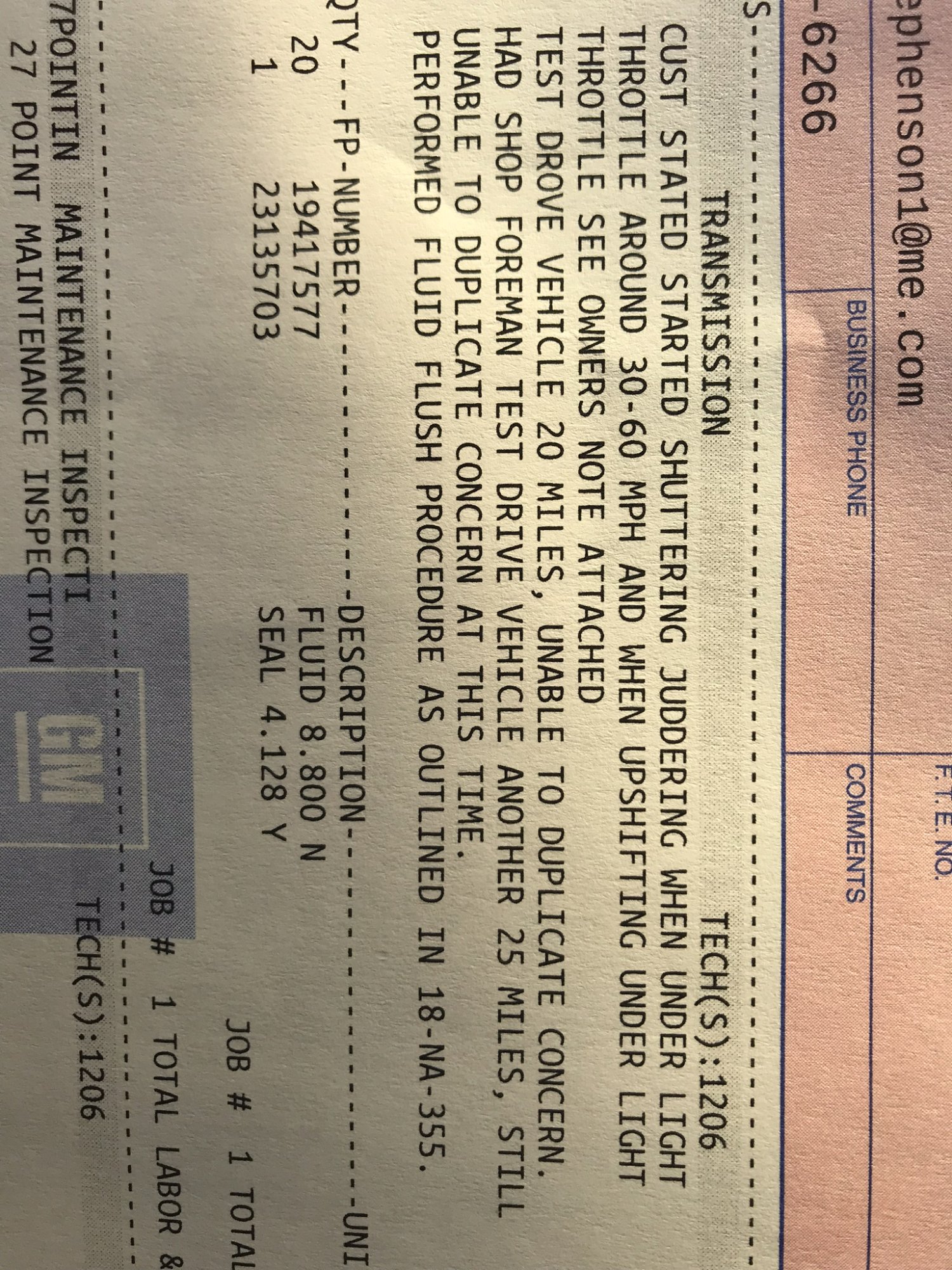

If it's your first time taking it to your dealer, I believe gm says that they have to flush the coolant first to see if that fixes the problem, prior to changing parts.....
Ok my dealer called me today about my truck. It is confirmed to be Torque Converter shudder by the mechanic at the dealership. They are changing out the TC filter and flushed out the TC three times. I am supposed to drive it for 200 miles and see if that fixed the problem. If not then they are going to put in a new TC.

I have this problem with my 2017 6.2 8 speed and I have had 2 converters and 2 flushes and the shutter keeps coming back. They will not work on it anymore until GM can find a fix.. BULLSIT
