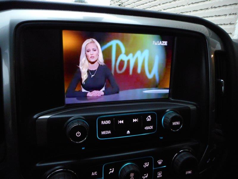

No big deal....just transfer *.mp4 files either in folders or directly in the root directory......it doesn't care. Plug chip into one of the USB ports in the console. I use one for audio files and a second for video files. Press audio off the main My Link screen and then press the media button on the audio screen first press hits usb1 and plays audio files, second press hits usb2 video files and the video (with audio) starts playing! After about 10 seconds the control button overlay disappears and you get full 8" screen video. Browse button presents list of all video files stored on the chip regardless of whether they are in folders or on the root directory.
Photo is a Tomi Lahren video file downloaded directly off Youtube to the thumbdrive with no alterations or transform of the file.

Running Windows 10, USB 3.0 slot and Toshiba 32Gig thumbdrive ........FAT 32.

Tried the same thumbdrive in my new '17 Impala with a non-Nav head and it recognizes the names of the folders but will not display names in them or play the *.mp4 files either in the folders or on the root drive. Maybe only the 8" head with Nav can play video files or maybe they changed it for '17.
In addition tried it on the 6" Nav head in my '15 Traverse and when the chip is inserted, the USB port on the touchscreen shows inactive and it will access USB via the media button only if there are audio files on the chip. But when the Picture icon is pressed on the touchscreen all*.jpg picture files even those buried a few subfolders down are shown and the pictures viewed on the screen.
Bottom line is only my '16 Silverado with 8" Nav head can play*.mp4 video files.

Well I just asked my dealer and he said video is not supported in my truck, I let him know in 2016 it was so he was going back to service to see if I can "go back" a version or two and or get a later update... this is a huge BS move on Chevy's behalf.. for the amount of $$ these trucks cost nowadays its unacceptable... they just want us to go buy 3rd party expensive overrides I guess. but even that's limited.. I also cannot wait for Android Auto to hurry up with WAZE maps to come out.. *I have IOS and Android so I would still be happy with it on Android*
