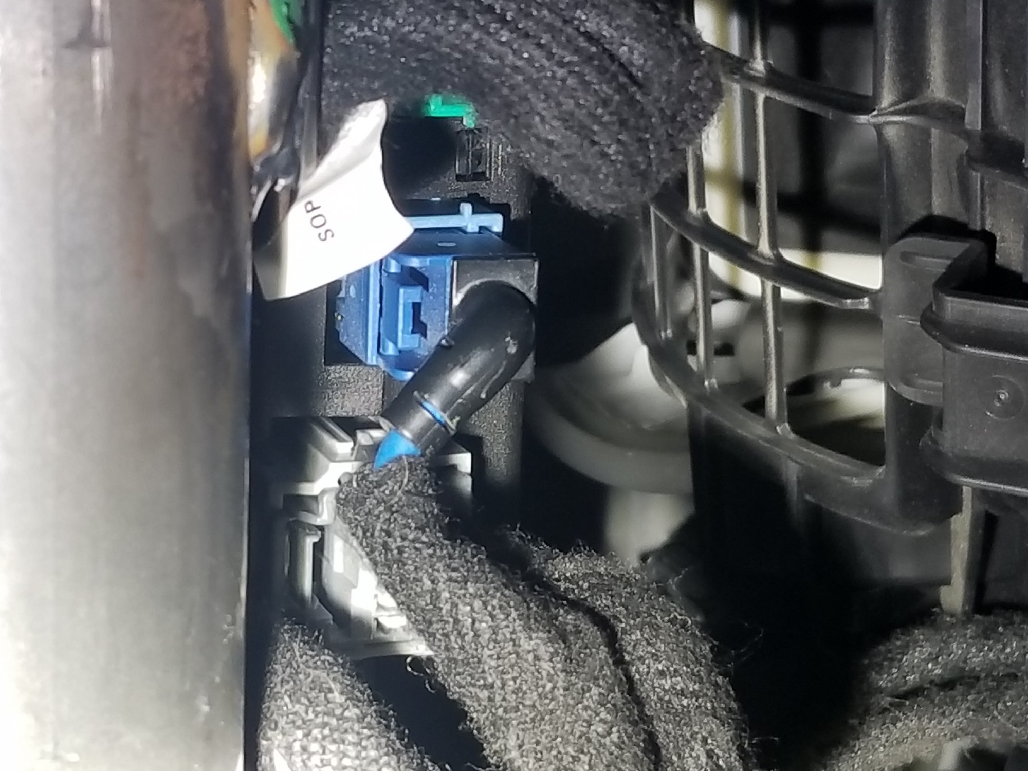

On my '14 Silverado when I first got it I changed the cabin air filter... Well, start the truck and no screen, but hear audio. Short story, there's a cable that runs from the screen to the HMI module, had a short. Worst part, had the truck a week, sitting there saying how the heck could changing the cleaner wig out the screen :)

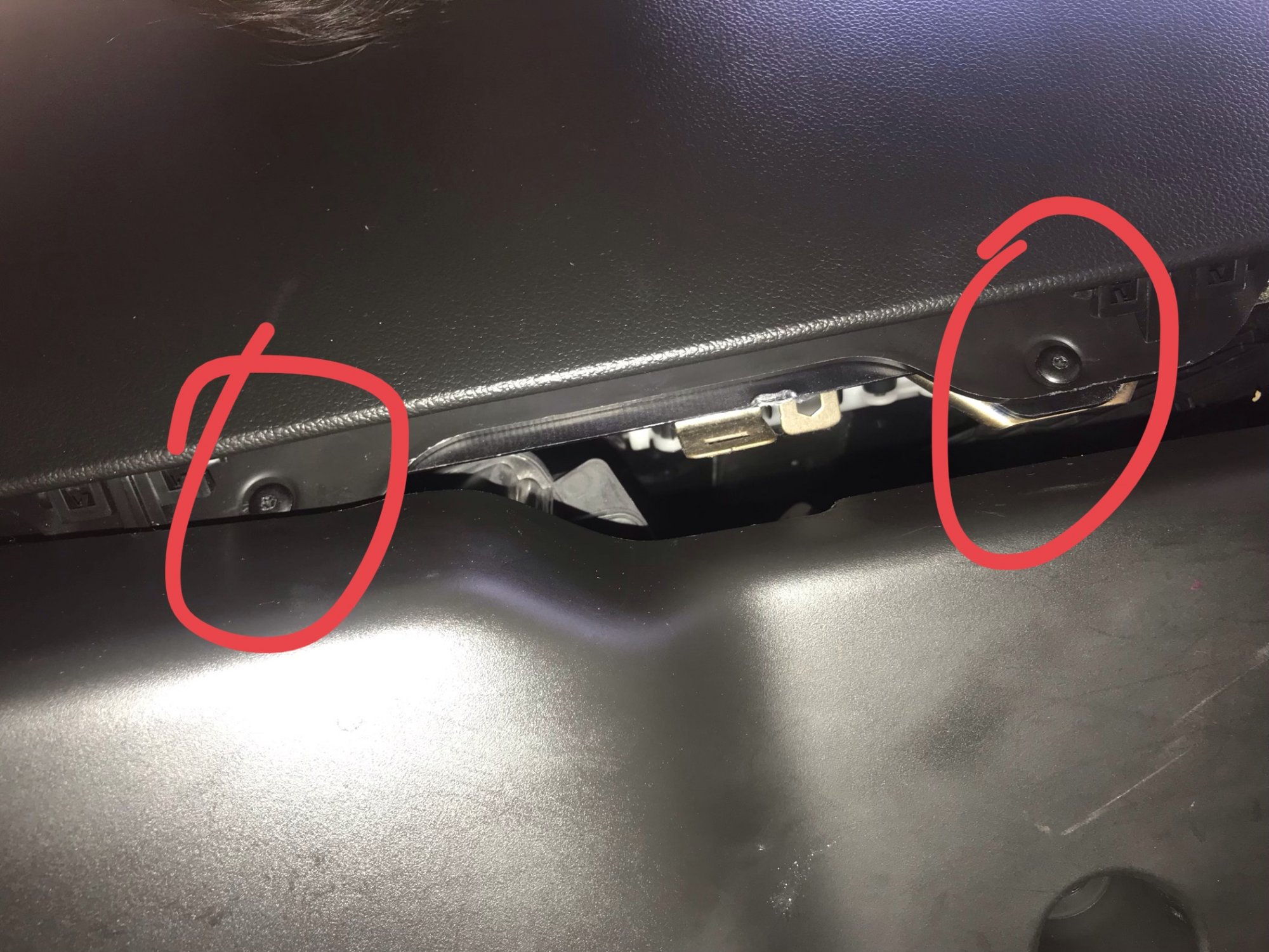

Yup, took 4 Torx screws to remove the bottom glovebox. As soon as I touched the blue connector, my screen came back. 10 minutes. Easy peasy.

I bought my 2014 Silverado with about 50k miles. Didn’t get any kind of extra coverage and about a month in my screen also went blank. Took it to the dealer I bought it from and they wanted to charge $200-$300 to fix. Didn’t think I should have to pay so I didn’t fix it. Touch screen still worked and so did the music so I just switched to the music screen in the dashboard and was able to control it from there. I read this thread yesterday and what Txrph said above works. Take four screws out of the bottom glove box look for that blue cable I unplugged it and plugged it back in and problem solved. I think the dealer says they have to order it and will replace it just to charge when in reality it’s not necessary.
