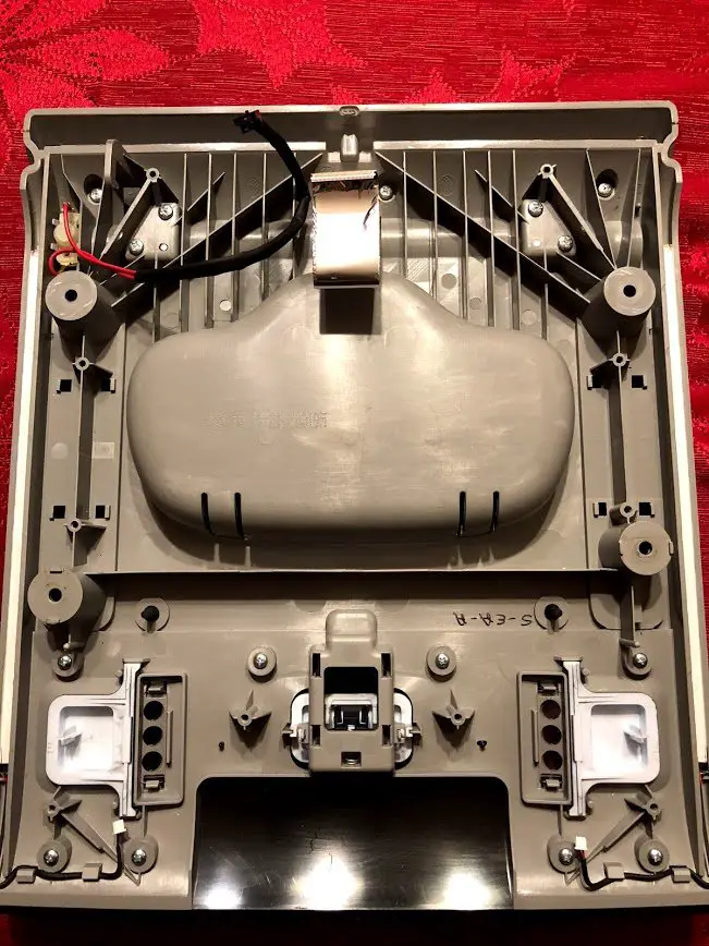

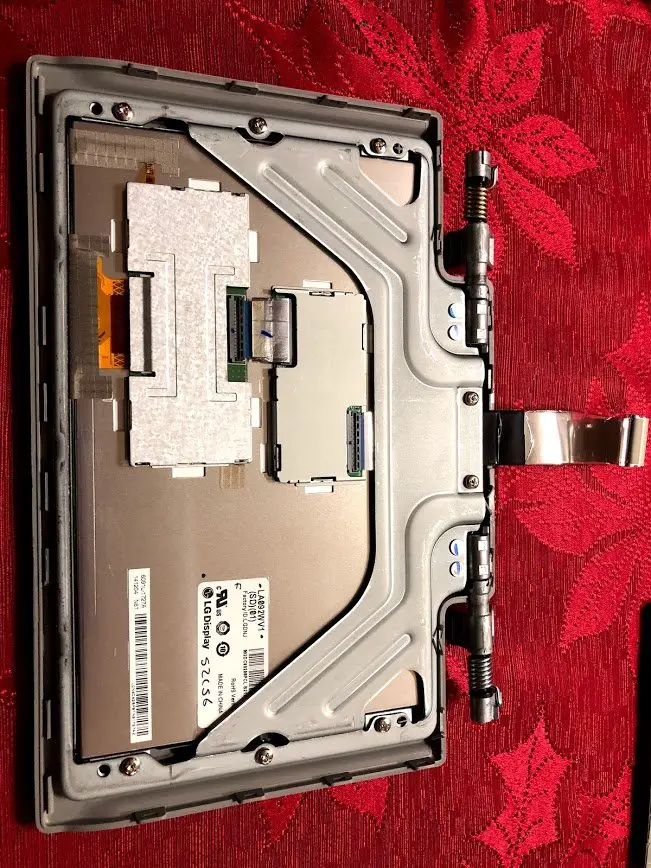

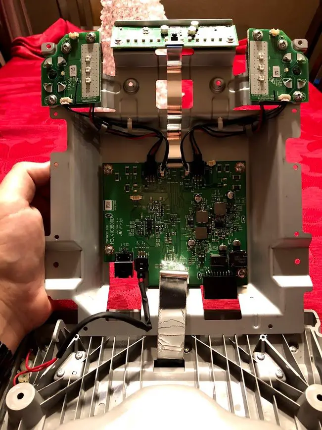

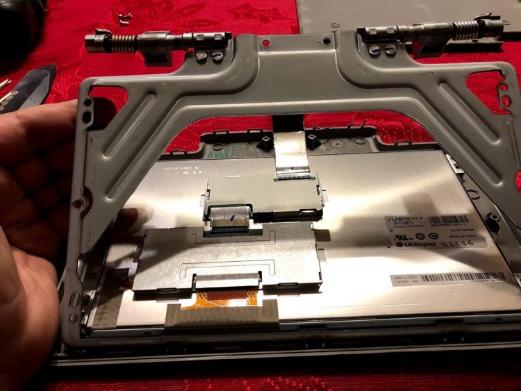

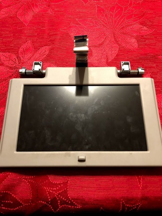

Same issue here. I figured it was the ribbon based on what others were saying. Dealer wanted 800 to replace. I took the unit down 4 screws and unplug 2 harnesses. Pulled the cover off and reversed the direction of the video ribbon. Issue fixed and it maybe took a total of 30 minutes. I did order a new ribbon on Ebay as a backup which cost about $20.00 it’s just a standard flat 40pin ribbon.
Hopefully this helps.
Anyone with second row overhead DVD issues in 2015+ GM suvs where the backlight works but no video, or you are unable to open the screen all the way without losing picture, the solution is easy. Remove, disassemble, and flip the 40 pin ribbon cable, reassemble, reinstall, and call it a day.
My 2015 Yukon XL Denali has just 50k on the ticker, and had this issue. GM is not standing behind the junk of a vehicle this has been within the two years of ownership, and I am not paying $700 to replace the second row DVD player.
I hope this helps someone with the same ridiculous problem. All you need is a Phillips screwdriver, a small flat-head, a ratchet/driver, and a 7mm socket.  This literally takes less than 30 minutes total to do.
