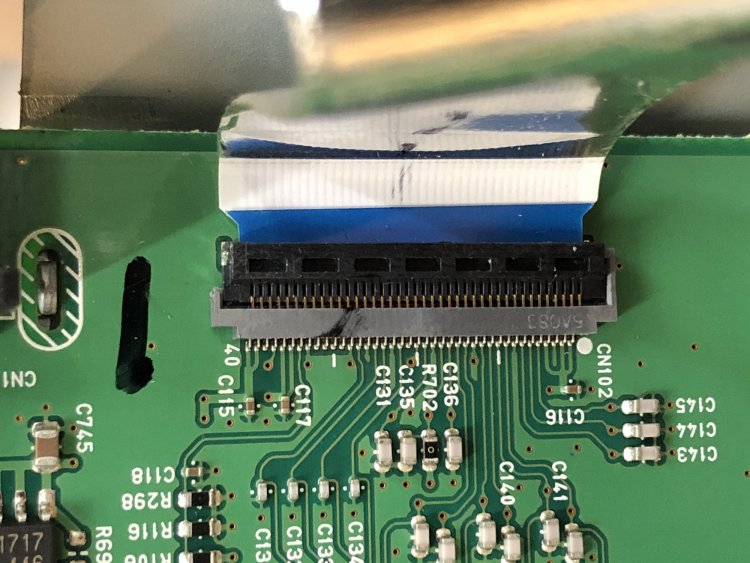

I will just add, in order to get the ribbon cable out, on my 2015 GMC Yukon XL anyway, is to flip the black part of the connector up, so the ribbon pulls out. It sort of hinges at those pins and only goes up about 30 degrees-ish (see pic). Hope this helps someone because I mangled mine whilst figuring it out.

Ok, so I'm at the point of removing the ribbon cable from the monitor but I don't know how to access the screen to remove the ribbon.  How do I get the ribbon out of the screen?
Thank you so much for this info!  I tried flipping the original ribbon around and it didn’t work, so I ordered new ones and it fixed the problem! ??  I thought the ones I got were smaller then the original, but I think GMC just put a protective layer over the one they used.
I wanted to share that I found my ribbon on amazon and it came with 20 of them...I mean I guess I’ll have replacements for a while! ? anyway they were only $6.99 plus it had prime shipping!

I’m not sure if you were able to figure it out, but you have to pry the screen casing open.  I first used a flat head screw driver, but the second time I did it (only because I needed a new ribbon) I got a cheap pry kit from amazon. I hope you got yours working!

Hey!  Yes, I got it to work.  I finally just pried it open, praying that I wouldn't break anything.  But once I got the screen open, replacing the ribbon was a breeze.  DVD player works great again.  Thank you!

Unfortunately this did not work for my 2015 Tahoe. I reversed the cable, but still have a black screen. Any suggestions?
I went ahead and ordered the replacement cables, just to see. Guess we will find out on Sunday when they arrive.
****UPDATE*****
Got my replacement ribbons to day and HOT DAMN IT WORKED!!!! So stoked to have my DVD player back and so are my 3 kids! Thank you so much for posting this.
