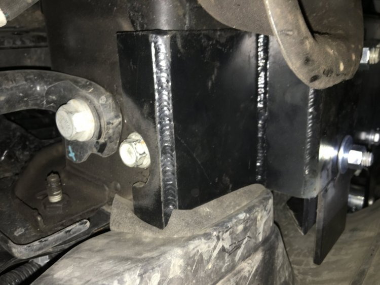

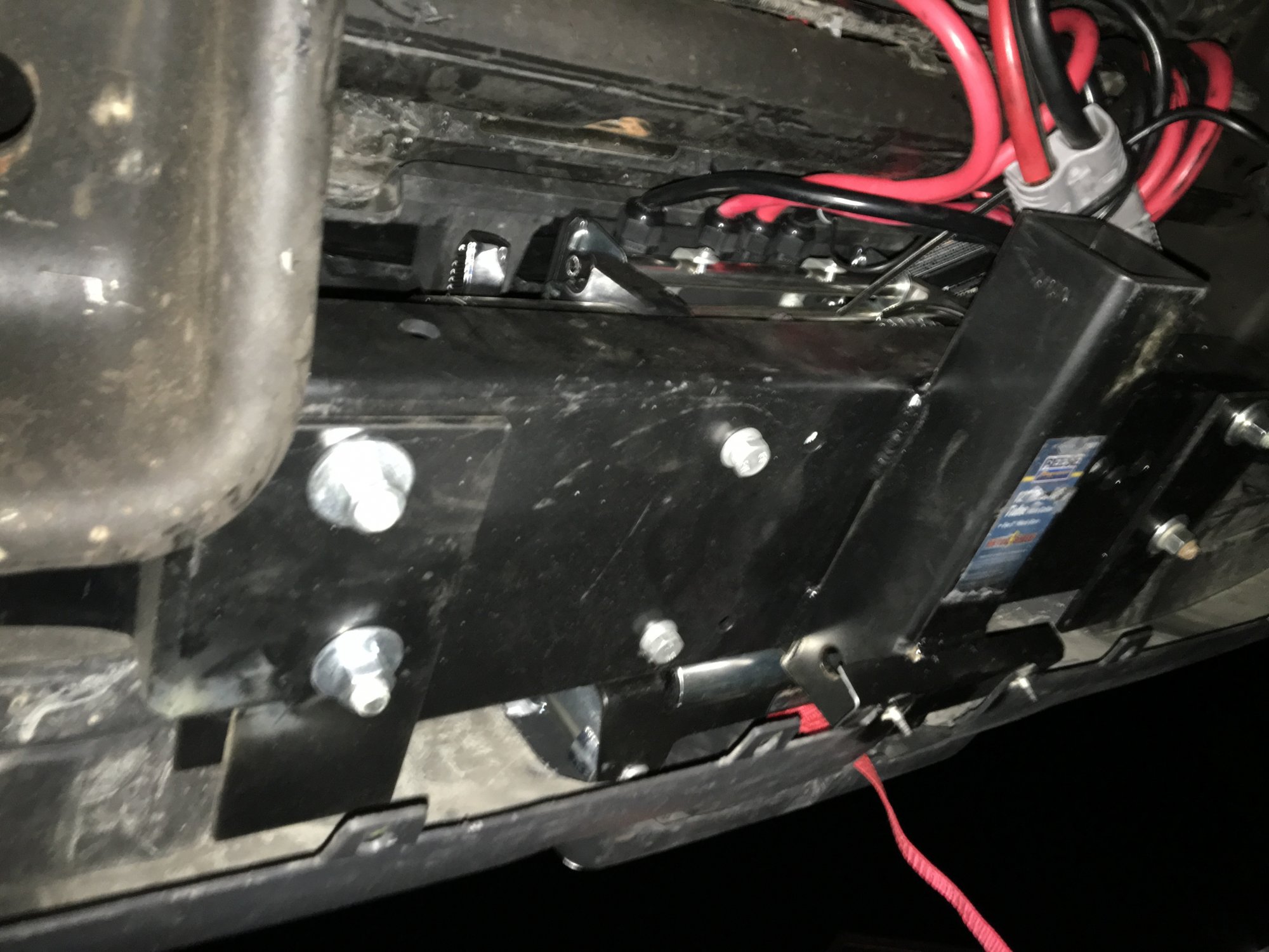

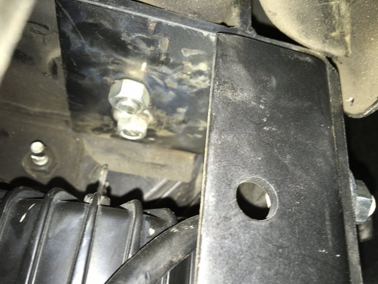

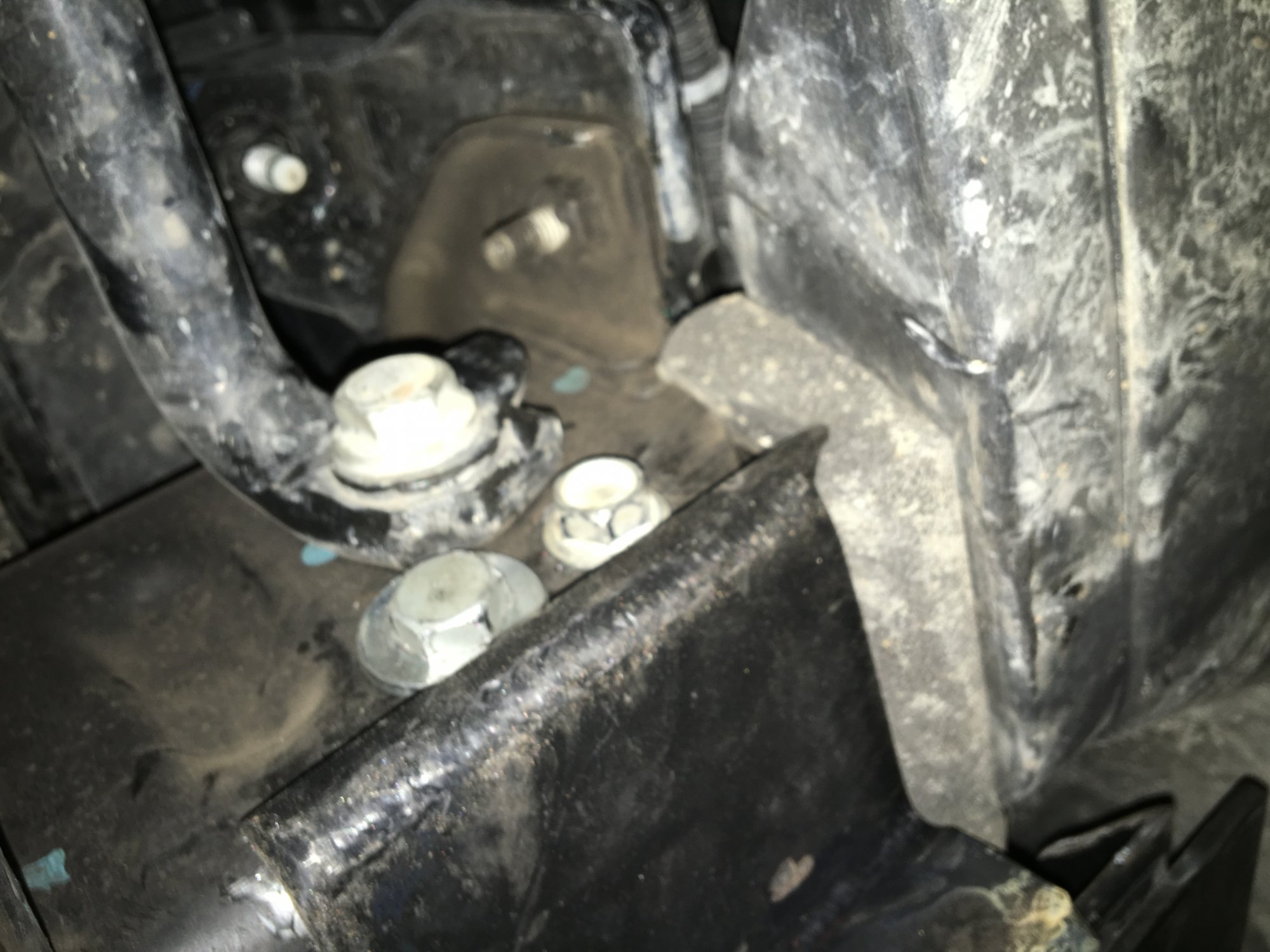

Here is mine. I will be posting more pics in the next few days with the brackets I built and plate setup. No one makes a bracket for a hidden winch because of the tow hook bolt placements. All brackets and plates were made of 1/4 inch steel. I did have to drill one hole and run a 4 inch bolt through the passenger side frame, rear hole of the tow hook for the bracket bolts. I also had to cut off the lower front bumper brackets. The winch was to wide to sit between them so they had to go. The last major mod was the lower facia being cut. The fairlead sits right below the metal of the bumper and I cut out the plastic of course. I also cut the plastic to fit a receiver and we welded a small piece of angled steel to the bottom of the winch plate and used the original screws and retainer nuts for the facia bracket. Last, Oregon requires a front license plate. So I used 1-1/4 conduit holders, drilled holes in the license plate and original plate bracket, and it just simply snaps onto the fairlead. Completely hidden. Winch is a Badlands ZXR 12,000 with wireless remote. I am unable to to to the spool lock, so no free spool for me on this setup unfortunately. I also ran quick connects 1/0 AWG wire to both front and rear of the truck. I will also be doing a hidden winch on the rear factory bumper of the truck in the coming weeks.

Driver side bracket. You can see that the bracket hugs the frame. You can also see that the bracket drops 1-1/4 inch and pushes forward so the the plate can clear the complex angles of the plastic facia. The passenger side is a mirror of the driver minus the extra hole for the to seat the inside bracket to the frame.

Passenger side bracket. You can see the “odd” bolt that we used to pass through the back of the tow hook. This is a 4” bolt. We bored out the threads on the back of the tow hook so it could pass through and drilled a hole in the frame on the other side. This is the only frame modification needed.
