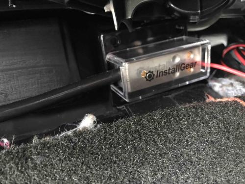

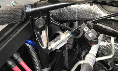

Next upgrade is to make the future easier. I ran 4 gauge wire from the engine bay to a distribution block in the cab.
This is how I will power future projects.

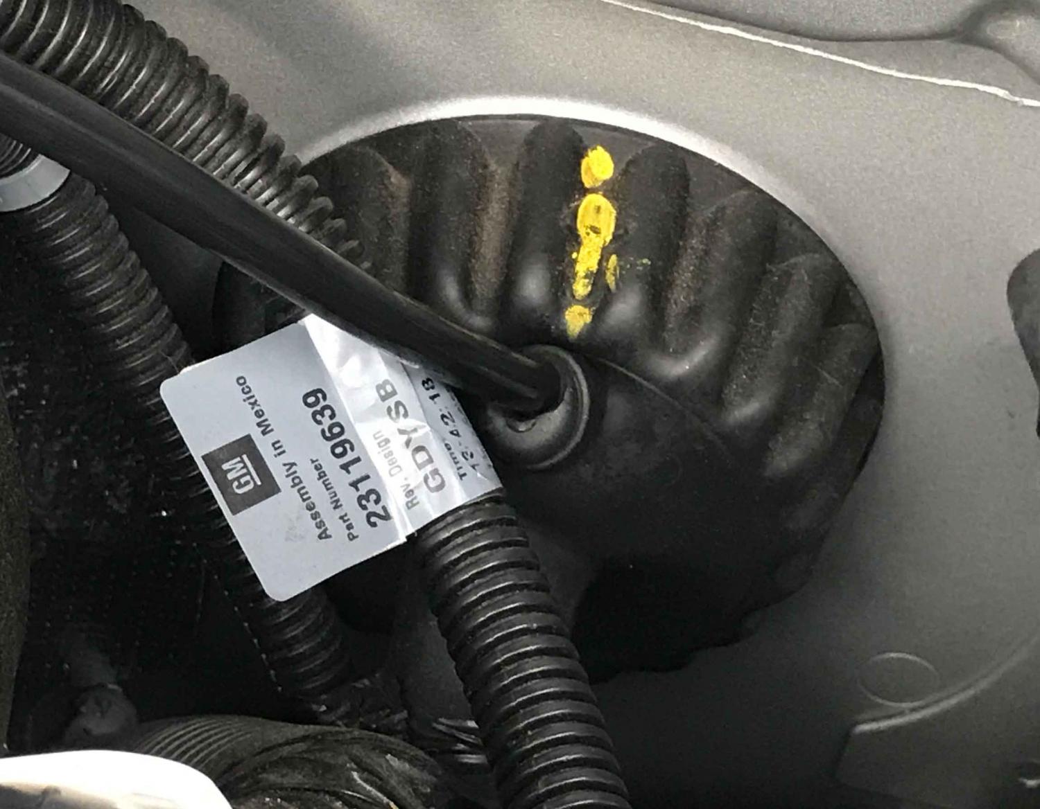

I used this method to get the cable through the firewall:
