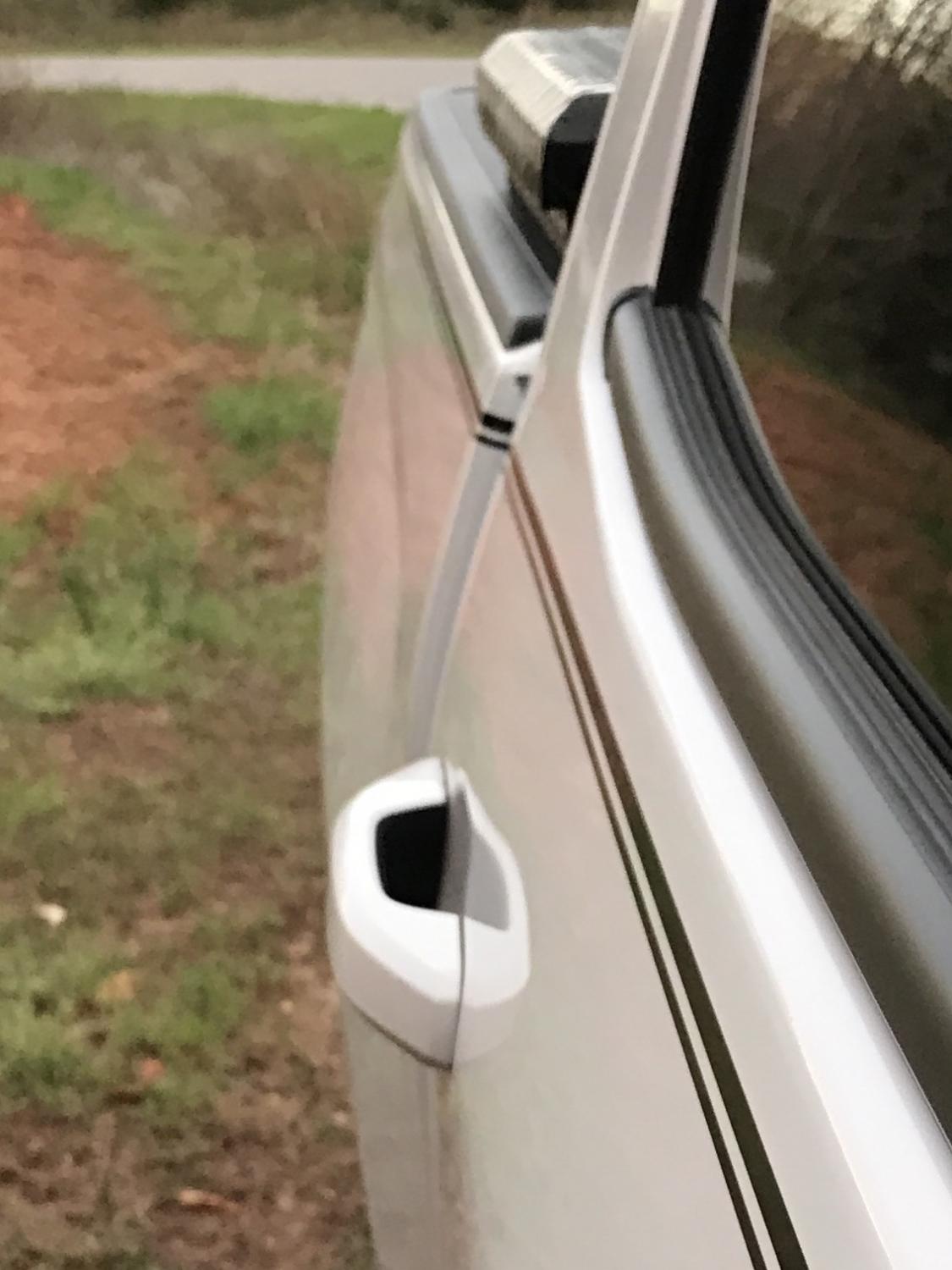

2017 Silverado bed and cab alignment
I don't know about you but $52k is a lot of money. I do expect a truck that is straight.

I doubt he went around measuring body panels to find it, only after noticing the bed sticking out one side of the body, at that point I'd have it corrected too, how does he know it was only the bed alignment issue and not a frame alignment issue, and as tight as the tolerances are in the wind tunnel it can cause wind noises, Hell I don't trust dealers enough to say that it wasn't in a small accident that the dealer corrected before the sale, I worked at New car dealers for 15 years in the 90's and 2000's, I've seen it done, Even if the left side of my grill had a 1/2" gap between the fender on the left side and flush on the right it'd be right to suspect somethings out of alignment.

Could be whole whole exercise in adjusting the bed may just have been a waste of time resulting in damage. All depends upon exactly how was it measured and was it first confirmed that both sides were misaligned? Only proper way to do it is to take a length of string at least three times as long as the truck, wrap it tightly all the way around the circumference of the truck, securing with masking tape at the same points at the far ends of the front and rear fenders so it is stretched (straight as an arrow) along the length of the truck and then measure the distance of the two points on each side of the truck where the string extends away from the surface of the cab or bed using a straight ruler.........any other way is useless because there are specs for bed width as well as cab width. Bed/cab misalignment as opposed to cumulative spec variance in the bed, cab body or both can only be confirmed if the distances exactly match on both sides, i.e. bed is 1/2" out on one side and the cab is exactly 1/2' out on the other. I had to check mine that way if for nothing else, just for laughs...and guess what? Mine shows 1/2" out on the passenger side and flush on the driver's side!!! So, I'm still gonna forgeddaboutit. Proved unless there was first a proper diagnosis, the cure was worse than the ill.
Dealership made things right. So a big thumbs up to Pinkerton Chevrolet in va. Highly recommend due to their customer service. Not many dealerships will ask "what do I have to do to make things right" and actually follow through.

No matter how you spin it, a bed thats sticking out 3/4" on one side compared to the other on a brand new vehicle is worth at least looking at, again I worked at dealers and seen them do shady things to cover up damage or repairs on new and used vehicles, If you trust dealers that much, kudos to you, but I don't.
