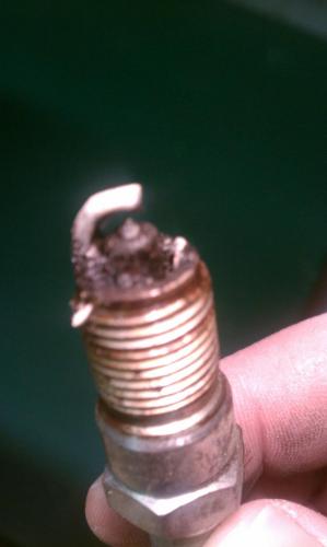

Here is a pic of a spark plug out of my 2009 5.3 engine it was using a quart of oil every 500 miles and fouling out the spark plugs. GM dealer did some work on it at around 80,000 miles after several oil consumption tests not sure if they fixed it or not I traded it right after I got it back to a 2014. The 2014 5.3 never used oil but I can tell you that I WAS CHECKING THE OIL DIPSTICK regularly!! and I still check oil in this 2016 6.2 it only takes about 1 minute and I typically do it while pumping gas. People do look at you strange it seems to be abnormal nowadays to even raise the hood. I had a lady walk by recently at the gas pump when I was checking the oil level and she asked me what I was doing I explained to her that I was checking the oil level in my engine. She looked at me incredulously and said she did not even know that the hood would open on these things LMFAO That seems to be the NORM nowadays
