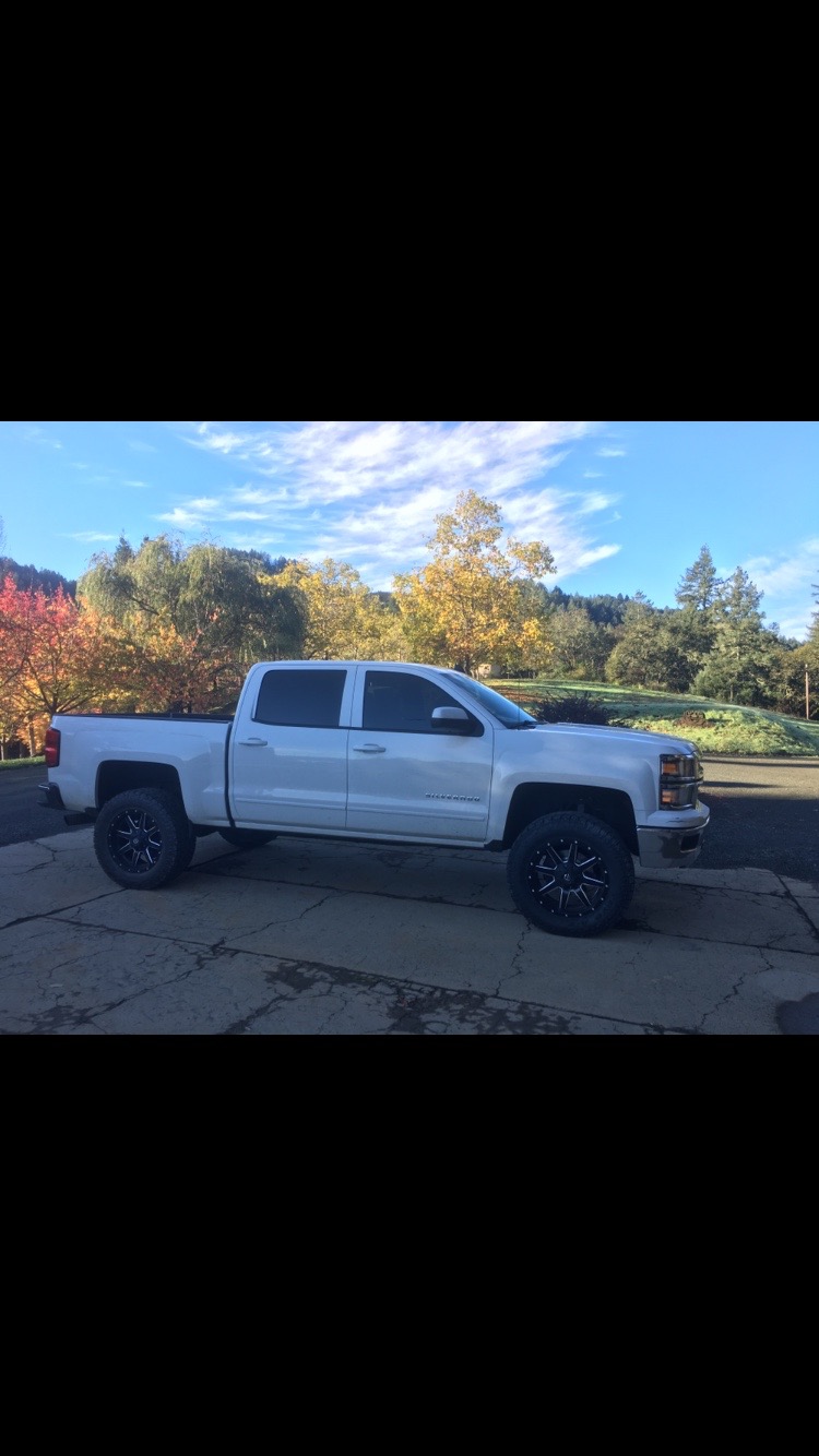

Really small picture but my truck is on the 4.5" lift with 20s on 35" Toyo's

I am the same decision as well with the traction bars. Could you provide me a link as well? Next, I have the 6.5 lift for zone. Did you put the lift on your self, or have a shop do it? Your truck looks good.
thanks! My last lift I did, this one my buddy did at his shop
