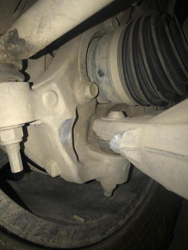

2015 Silverado lower control arm hitting inside part of brake system
hey guys I have a 2015 Silverado 4x4. Was doing some off roading and messed my truck up there is a major rubbing issue. ill send pics to show you whats rubbing. any ideas whats up with my truck
heres another
another
Honestly I've seen this on trucks without oversized rims that only drive on pavement. You sure that's the only place where it's rubbing?
hey guys I have a 2015 Silverado 4x4. Was doing some off roading and messed my truck up there is a major rubbing issue. ill send pics to show you whats rubbing. any ideas whats up with my truck attachicon.gifIMG_0739.JPG.jpegattachicon.gifIMG_0738.JPG.jpegattachicon.gifIMG_0740.JPG.jpeg
heres another
another
That would be your steering stop. Your bad luck is that it is aluminum. The only option for you is to smear a good grease on both sides to slow down wear.
