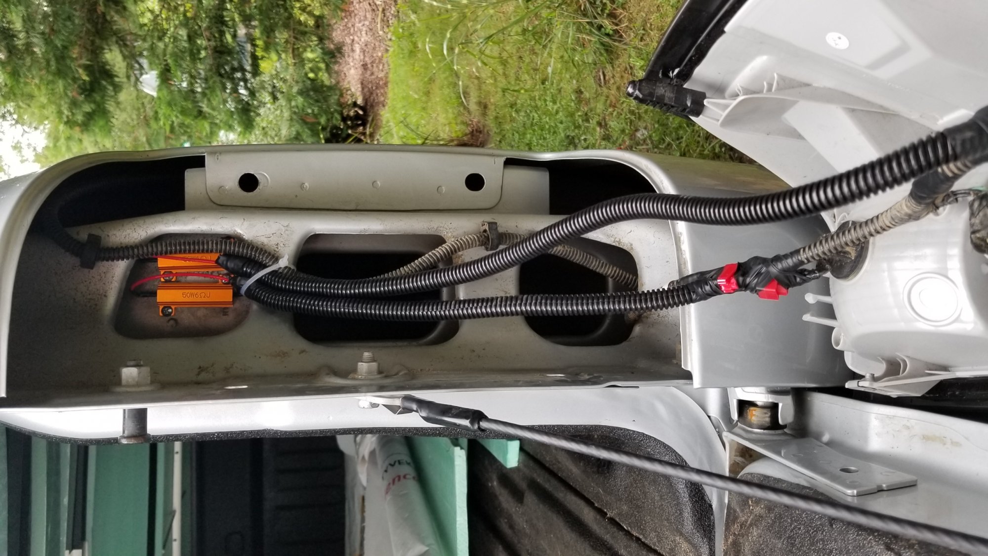

I have had no issues since intalling two 50W resistors each side. I have not installed LEDs in the front, so maybe a snafu will rear its ugly head yet. *knocking on wood*. Thanks to this forum and YouTube, my smoked tail lights with LEDs look and work great. See below for how I mounted the resistors. Sorry for the sideways pic. Don't know how to rotate here. Looks like default is for landscape....
