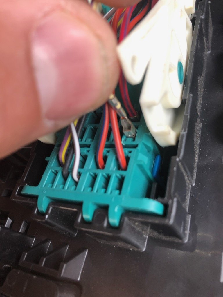

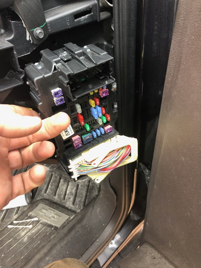

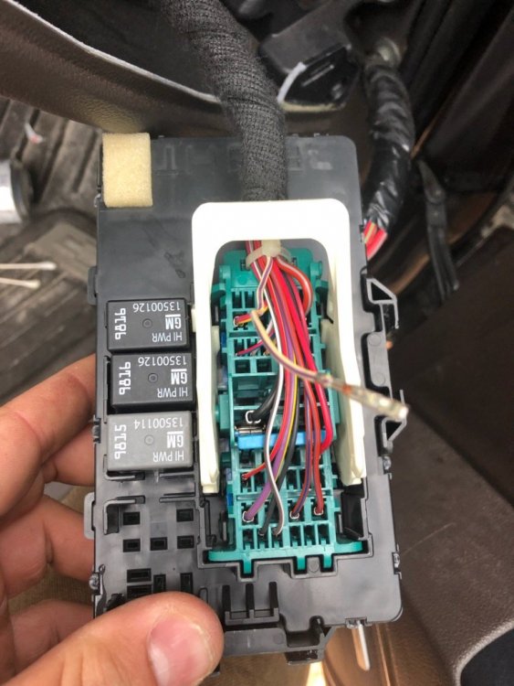

Cargo, bed, and mirror lights Solved. Use them whenever you want. This is on my 2016 Chevrolet 2500 LTZ crew cab. Trucks may vary depending on model and year.
How I did it-
1. Locate “Cargo Lamp” fuse. Mine is fuse 10 in the passenger side fuse panel.
2. Remove fuse box from its location. (Mine came out with harnesses plugged in) tabs that hold it at 10 o’clock and 1 o’clock.
3. Pull fuse and use a multimeter on connectivitybuzzer setting. Find the two wires Positive IN and OUT by touching one side where the fuse plugs in and the other to the harness wires plugged in on the backside of the fuse block.

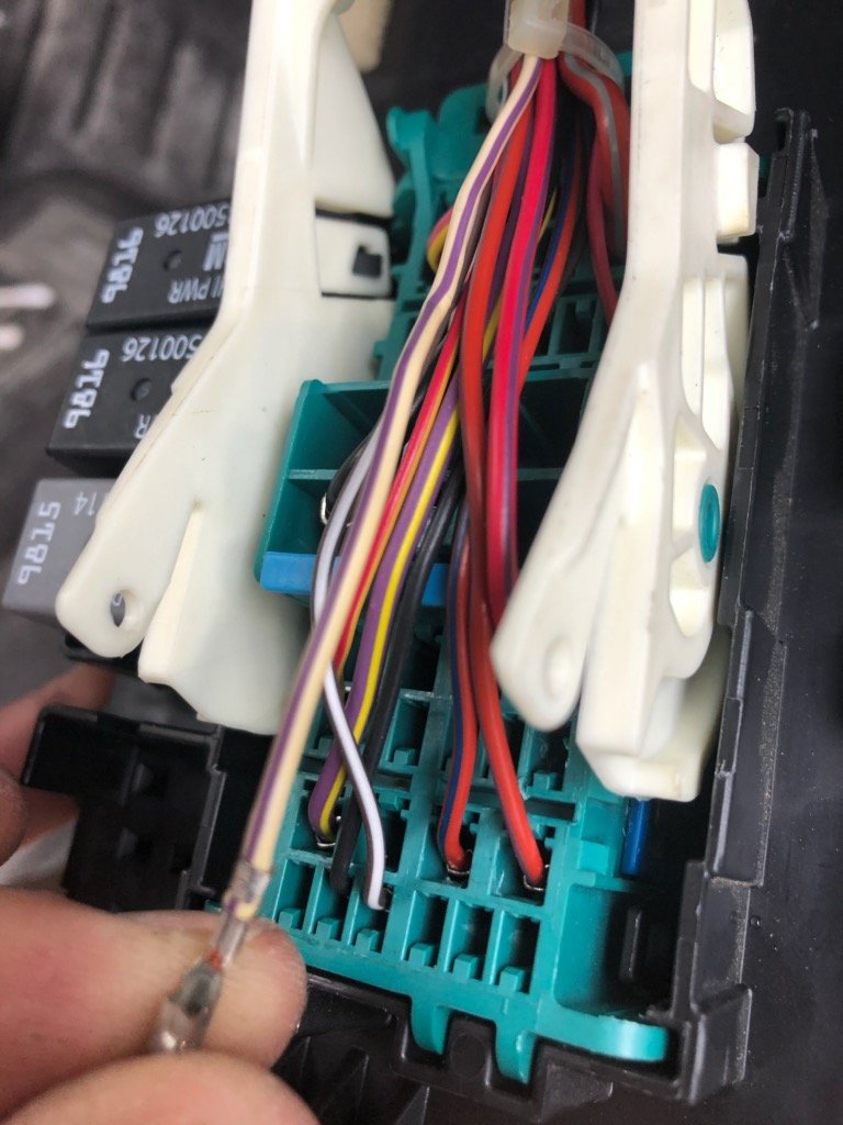

4. Switch to low voltage setting on your meter. One wire should be Hot (12-13v) and the other no voltage = this wire sends positive to the lights. Mine is an OFF WHITE with Purple stripe.
5. I unplugged the harness, removed the front blue colored retaining clip, and used a tiny screwdriver to press the retaining tab down to remove.
6. Wire to a switch with a fuse to any 12v source you prefer.
**The original switch will not operate the lights anymore but it will glow and display in the dash as before if you press it.
**the bed, cargo, and mirror lights now operate independently of the truck whenever you want.
