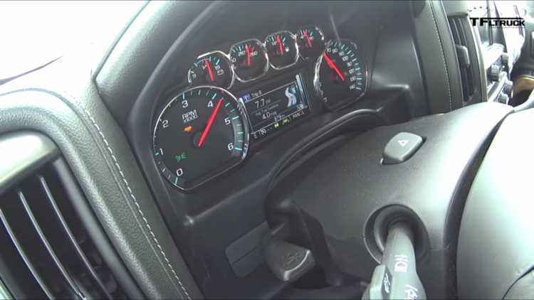

I just can't understand why with just the slightest engine load or downshift with increased rpms the water temp would rise that quickly, reguardless  if the guage is accurate or not. Wonder if it's something to do with the sending unit or perhaps it something mechanical like impeller speed or something. I haven't looked at the dynamics of the cooling system.
got ahold of a scanner, and fro. What I see the temp gauge is reading low actually. And the temp rise is rpm based, and with engine load it rise more . Normal cruse speed of 60mph and rpm of 1500 it's running 214 and showing 210 put it in manual mode same speed and rpm of 2200 temp goes to 220 on scanner and gauge show about 215, punch it or go up a long incline and temp goes to 228 gauge shows slightly over 215 closer to 220. I don't even have a load on the motor such a trailer or anything just increasing rpm makes the temp rise.got ahold of a scanner, and fro. What I see the temp gauge is reading low actually. And the temp rise is rpm based, and with engine load it rise more . Normal cruse speed of 60mph and rpm of 1500 it's running 214 and showing 210 put it in manual mode same speed and rpm of 2200 temp goes to 220 on scanner and gauge show about 215, punch it or go up a long incline and temp goes to 228 gauge shows slightly over 215 closer to 220. I don't even have a load on the motor such a trailer or anything just increasing rpm makes the temp rise.
was hoping someone else with the same truckwould chime in if they are experiencing the same thing. I just watched a video of the gauntlet test with a 17 6.2 he is pulling a 10,000 trailer, I screen shot the temp it's really high. Now granted the shot is from the left side so it's not quite as high as it looks, but still pretty high

also tfl truck is towing 10k pounds, up a hill, at wot, for like 10 minutes straight.
I’ve owned cars that would blow up if you went WOT for 30 seconds straight, let alone 10 freaking minutes.
This isn’t a tractor trailer, or a diesel.
10 minutes straight at WOT for a 420hp sports car engine is absolutely nuts

what is the only thing that could cause extremely fast rise in water temps under low load conditions
extremely efficient transfer of heat
its the only thing that makes sense
The water is heated by transfering heat from the coolant passages. A lot of temp fluctuation is great if you ask me.
I see this engine uses piston cooling jets , I wonder if there is a malfunction in this system that could be causing the temp to rise. And is there a way the tech can check operation of the system without tearing into motor
