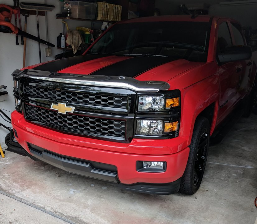

I couldn't resist taking a picture today after basketball. Truck needs a wash.
I'm thinking I need to get the bumpers color matched. Anyone have any recommendations on the best way to do that? Also thinking about painting the valance black. Anyone tried painting their valance? Recommendations?

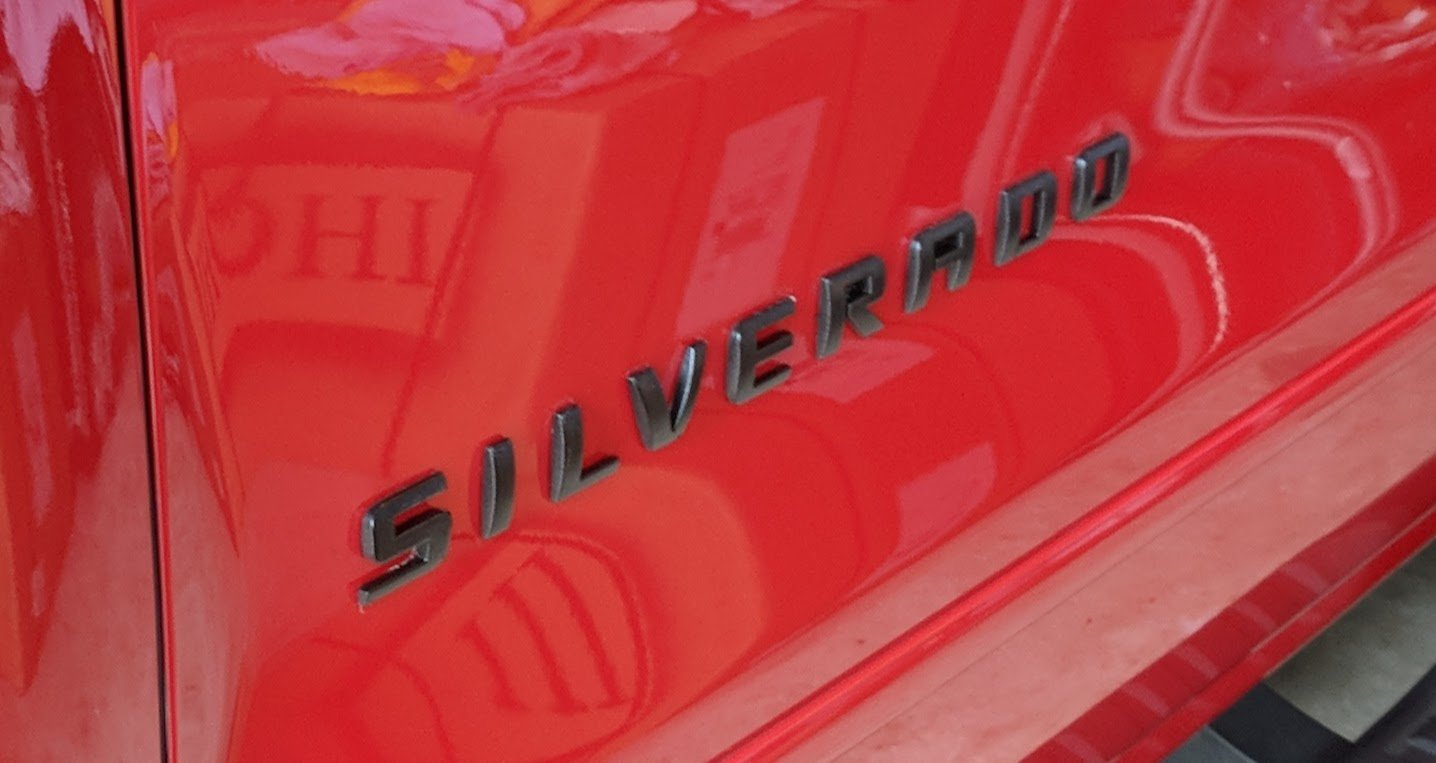

While I was at it I figured it made sense to plasti dip the Silverado nameplate on one side of the truck to see how it looked as well.  I think it looks great, but I need to upgrade from the plasti dip.  I saw replacements on eBay in gloss black that I will probably pull the trigger on after getting the lowering kit installed.   Thinking about replacing the LT on the tailgate with RALLY.  Not sure yet.

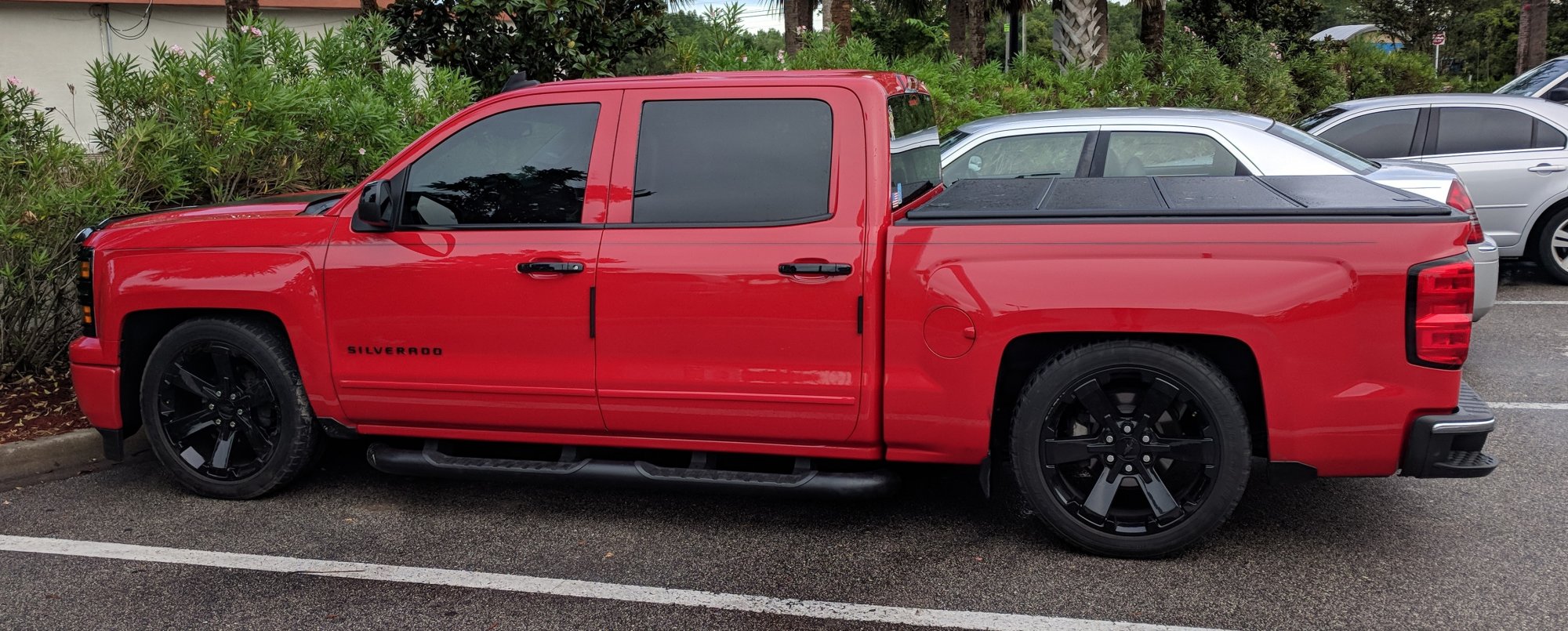

The pictures below make the truck look pretty level but it is still a touch lower in the back.

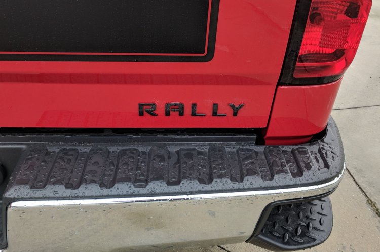

I also had that same shop replace the chrome emblems that come with the truck (and really look out of place on the Rally editions) with black emblems.  I had a custom RALLY emblem made up to replace the LT on the tailgate.  Ordered all these on eBay.  The RALLY emblem was a custom that one of the sellers agreed to do for me at a very reasonable $20.  The black is so much better than the chrome on this model/color scheme.  Couldn't be happier with this mod.  Note the lettering perfectly straight though the picture does not look like it is.  Not sure if this is due to the rain or a strange picture angle or what.

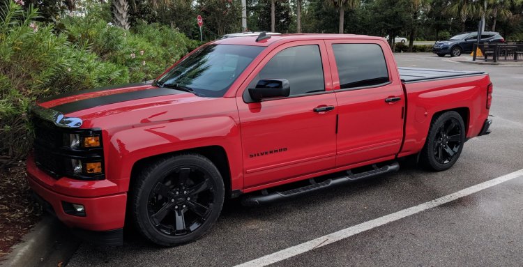

Been awhile since I posted.  I did finally get the truck at a level I liked.  The post above shows it at its lowest which was well below where I wanted it.  I finally got it adjusted to approximately a 2/5 drop and I think it looks great.  I won't go into the whole saga with this since I covered most of it in the Lowering thread while I was going through it.  I ended up using Belltech drop spindles to lower the front end and a flip kit in the rear.  As I noted above I initially had the Inez lower control arms installed but the drop was more than I wanted in the front and the front wheels really moved backward in the wheel well which was no supposed to have been the case.  I ended up having the OEM lower control arms reinstalled and added the drop spindles to get the drop I wanted and this also reduced the amount the front wheels shifted back.  Its perfect with the exception of the front wheels shift rearward.  Picture below gives a view of my ride now.
The turning radius has been hampered somewhat to avoid rubbing and while I have gotten somewhat used to it I would really like to have the OEM turning radius.  The upper control arms are the controlling factor based on discussions with my guy at the alignment shop.  Nasty recommended Twisted Metalworkz camber correction control arms to replace the OEM upper which would allow the wheel to be moved back forward.  Saving up my pennies to get that done and hopefully be finished with this issue.

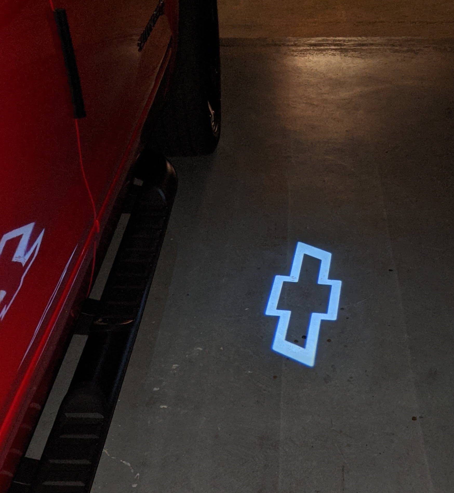

I while back I found the thread that showed how to upgrade puddle lights on the DL3 mirrors to the Chevy Bowtie.  I always thought something like that was a cool idea.  Sold on getting this done I got on Facebook Market and found a pair of the DL3 mirrors for $150.  The seller ended up dropping the price to $100 since I had to drive 2 hours to meet him.  The mirrors were in great shape.  I used the conversion harness from Dr. Harness.  The directions were great and swap went very well.  I was able to get the mirror caps swapped out from the typical chrome to the glossy black that coems on the Rally without breaking any of the tabs. Wiring the harness was something Iwas worried about because I didn't want to screw it up but after double and triple checking before I put them in the end result worked out perfect.  This Christmas my wife was good enough to get the bowtie puddle lights.  Tonight I put them in and, while they are oriented perfectly yet, they look great.  I was concerned about the brightness but they look great.  Tomorrow I will be able to test them in the daylight.

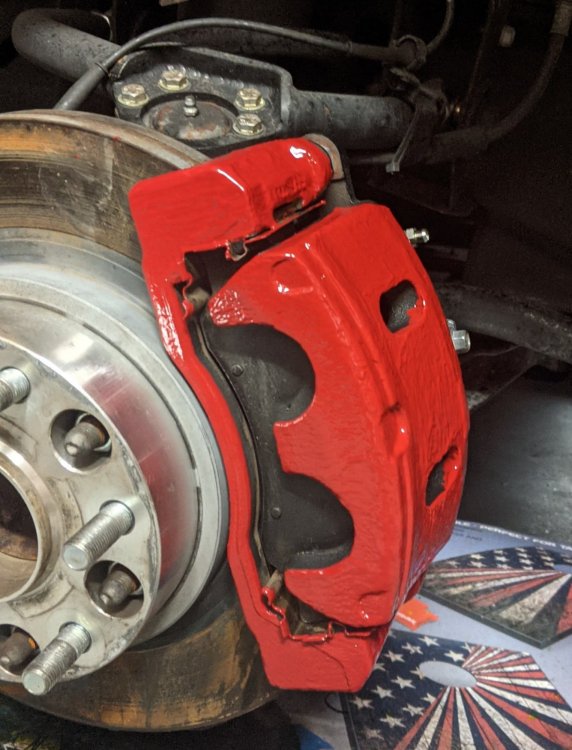

I had always liked the look of colored brake calipers.  One of my boys got me the Duplicolor Brake Caliper painting kit for Christmas last year.  Given you can’t drive the truck for at least 24 hours after painting I just had not found the time to tackle this project until this week.  One of my boys is out of town and we were able to use his truck for the week.  This gave me the opportunity to finally get this done.
Getting all the prep work done took some time.  All the research I did before getting starting emphasized prep as the biggest factor in getting a good result.  I cleaned the calipers at least three times each starting with Brakeleen and Adams Wheel Cleaner before sanding with 80 grit and then 400 grit sandpaper before finishing up with the t Duplicolor cleaner that comes with the kit.  The kit is brush paint kit so I didn’t have to mask much though.  One garbage bag each wheel was all I did for masking.
As recommended in my research I did not use the provided paint brush and got a better one from Lowe’s.  The paint is very thick.  I probably put on too heavy a coat on for the initial coat.  Part of that is that as I tried to avoid brush strokes I kept putting on more paint to try to smooth out the paint.  Overall it did not come out very smooth but unless you are up close you don’t see the imperfections.  If it bothers me, I have read that it can be sanded down.  I’m going to give it a couple of weeks to see what I think.
