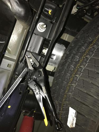

For those of you, like me, who are installing the dual behind the tires kit you will need to remove the 34MM (7/8" works, luckily) nut off one of the rear bed bolts (see pic). This bolt will spin (ask me how I know) so you'll need to get something on top to hold it. I ended up putting some vice grips up top to hold the bolt.

I found it much easier to use a socket and a wrench on those bolts. Those are the hitch mounting bolts and you can reach the head of the bolt with a wrench inside the frame rails easily.
