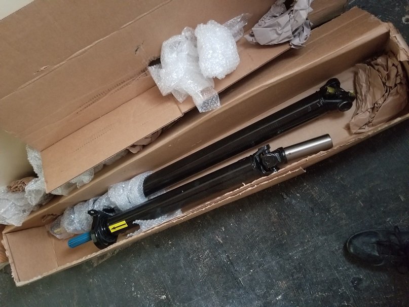

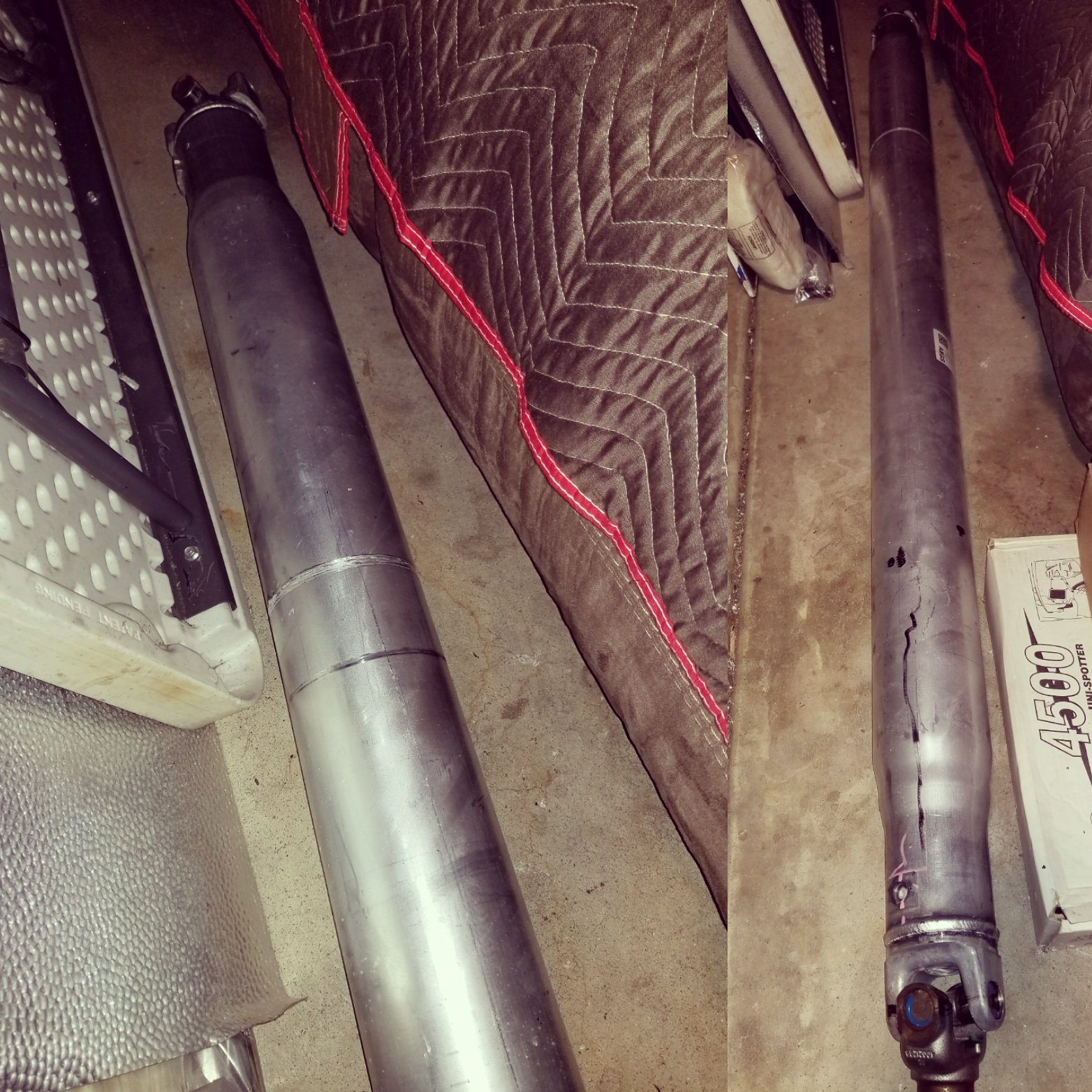

Finally got the new driveshaft and helper bags in this weekend.  Aluminum driveshaft versus steel gas tank crossmember was not a good combo.

Details on the drive shaft please company and price. I'm looking at a 5" aluminum and new yokes and it is $800.
I ordered the kit from Performance Driveline in Cali.  The kit was about 700 shipped.  They also offer a high HP version for another 100.  Really nice quality pieces.  I'm very happy with it.
