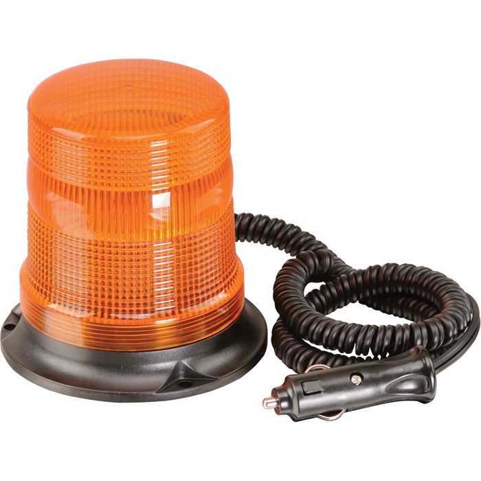

Since you asked, I use a magnetic strobe from Northern Tool for 19.99. I like it because I only use it a couple months a year, then I remove it. I wired a trailer harness to the pigtail that I can plug into my trailer connector so the strobe comes on when the headlights are on. This way I avoid having any wire penetrations into the cab. It's actually on my truck in the photo in my avatar. You can see how small it really is.
http://www.northerntool.com/shop/tools/product_200617141_200617141?cm_mmc=Google-pla&utm_source=Google_PLA&utm_medium=Automotive%20%3E%20Emergency%20%2B%20Vehicle%20Lighting%20%3E%20Beacons&utm_campaign=Ironton&utm_content=40499&gclid=CjwKCAjwk4vMBRAgEiwA4ftLs3wccQyId493oG_2vVk2xgBj4dtKrrPh9RMPjyED9otele-mwLpvkRoCnwwQAvD_BwE
