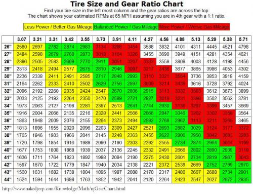

This has been helpful over the years. Hope this does the same for you.
Interesting chart! Looks like it was built for Jeeps with their engines, trannies and rear ends. Doesn't really fit any experience that I have had with my 2014 Tahoe or 2017 Silverado 1500. Any equivalent charts for GMs?
It works, gear ratio's don't change as long as you are 1:1 drive ratio in the transmission. What it states, is that GM gearing sucks in the 1/2 ton trucks. It is for fuel mileage. Now the 4th gear in your truck is still not exactly 1:1, but close enough. Now with some configurations with Max Tow Packages, you can get the 3.73 gear ratio. Going from 3.73 to 4.11s is only 250 rpm.
Do me a favor, the next time you are going down the highway at 65 mph, drop the transmission into 4th gear and see where you are at with the 33" tires. It will be close to the chart.

That would be 6th gear and 31" tires. I get great mileage and it tows like a champ.
What would be in 6th gear?
Transmission. I have the 8R90 8-speed. The 6th gear is 1:1 and the tires are 31". With the 3.23:1 rear end that would put the RPMs between 2262 and 2333 on your chart above. I get 2263.7 RPMs for the 3.23:1 rear end in 6th gear at 65 mph.

Okay so i wanted to report back on this. At 65MPH in 4th gear my RPMs are at about 2600. Im thinking the 4.10's would be perfect for my 6 speed and 33"s...
