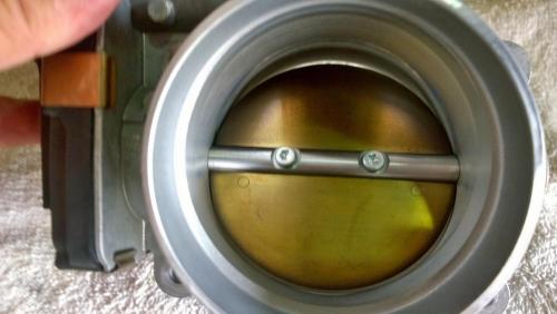

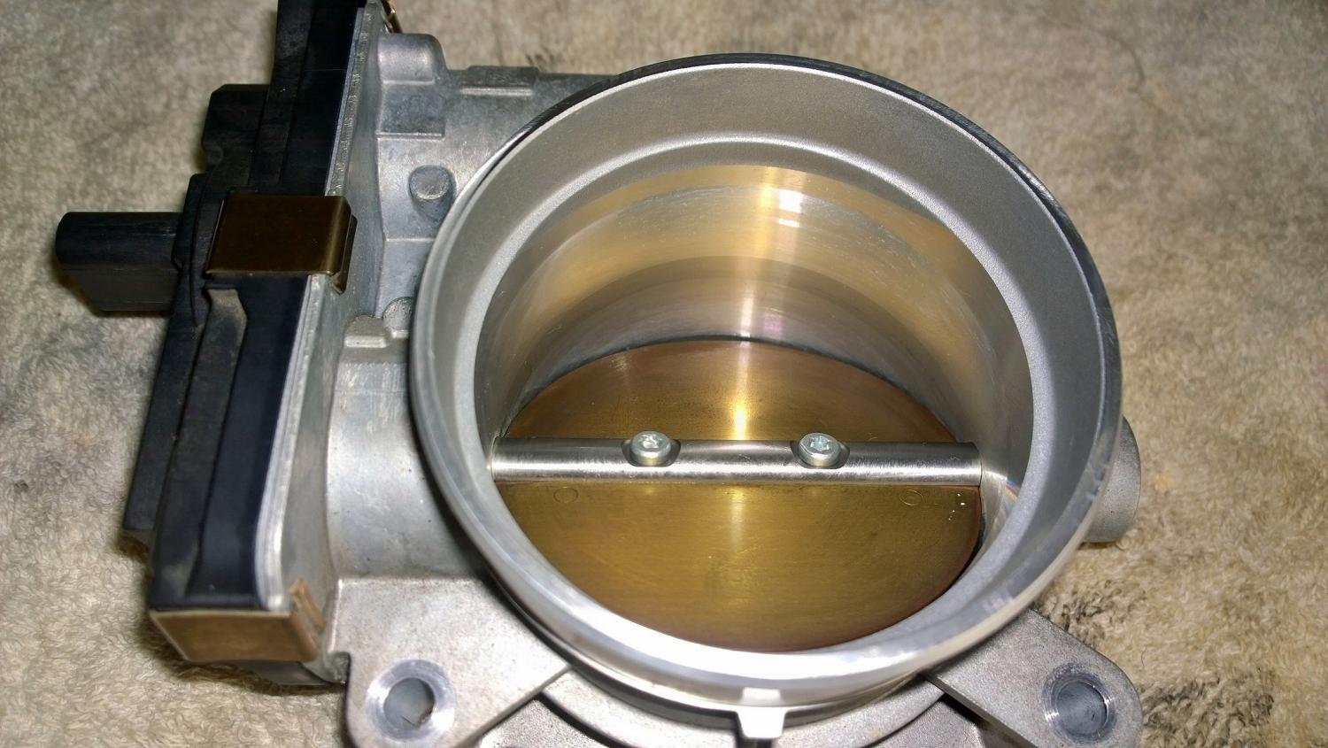

I will post before and after pics of throttle body but I did not consider it bad either. I guess I got lucky and got a really good '14....
