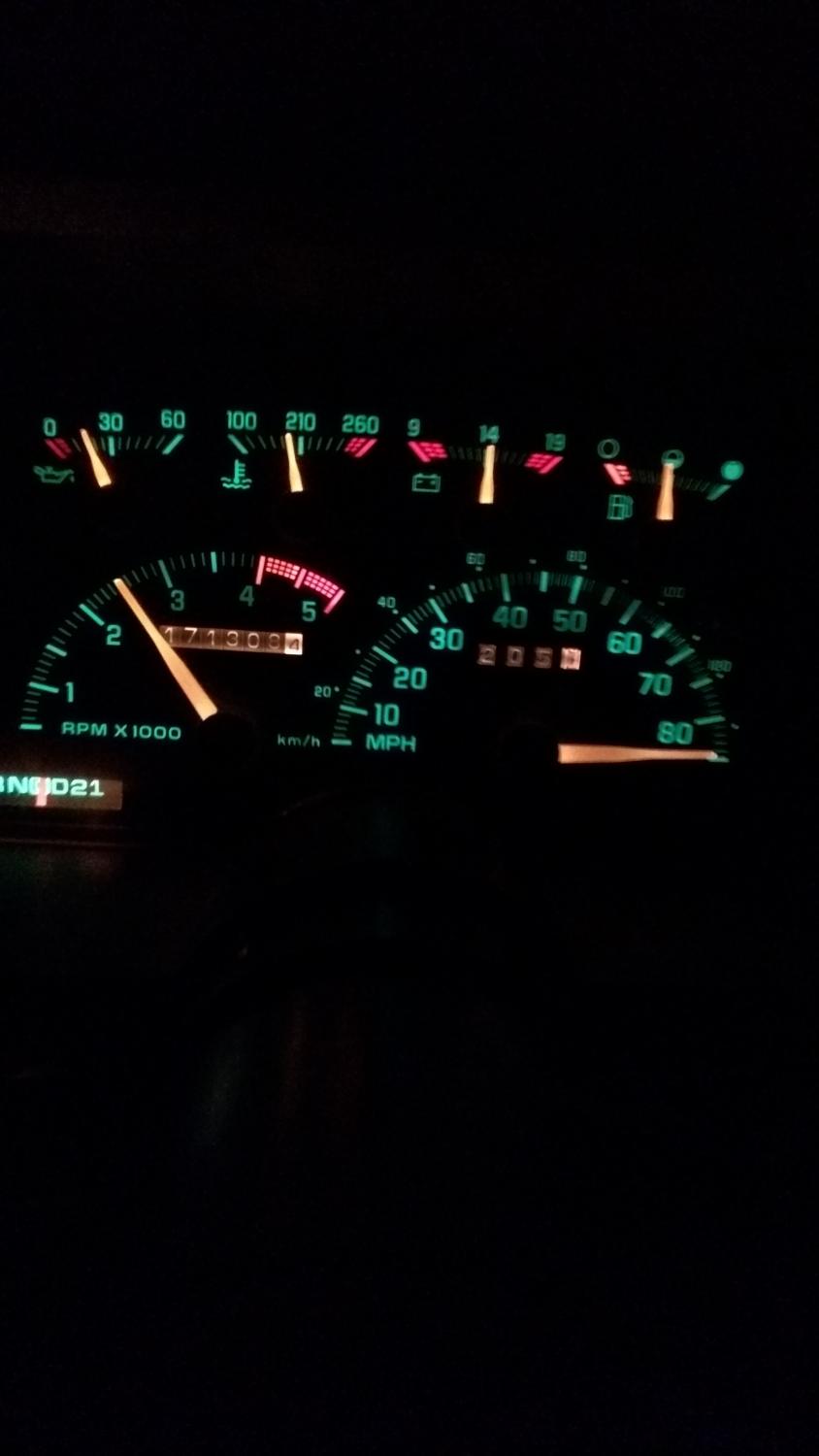

Oil pressure is a bit low, ain't it?
It's the gauge itself, I changed the sending unit etc. Everything else checks out good, been that way since I purchased it used 24 years ago.
I have an 89 with the same issue....

No redline on instrument cluster on 97 - 99 vortec 5.7 350

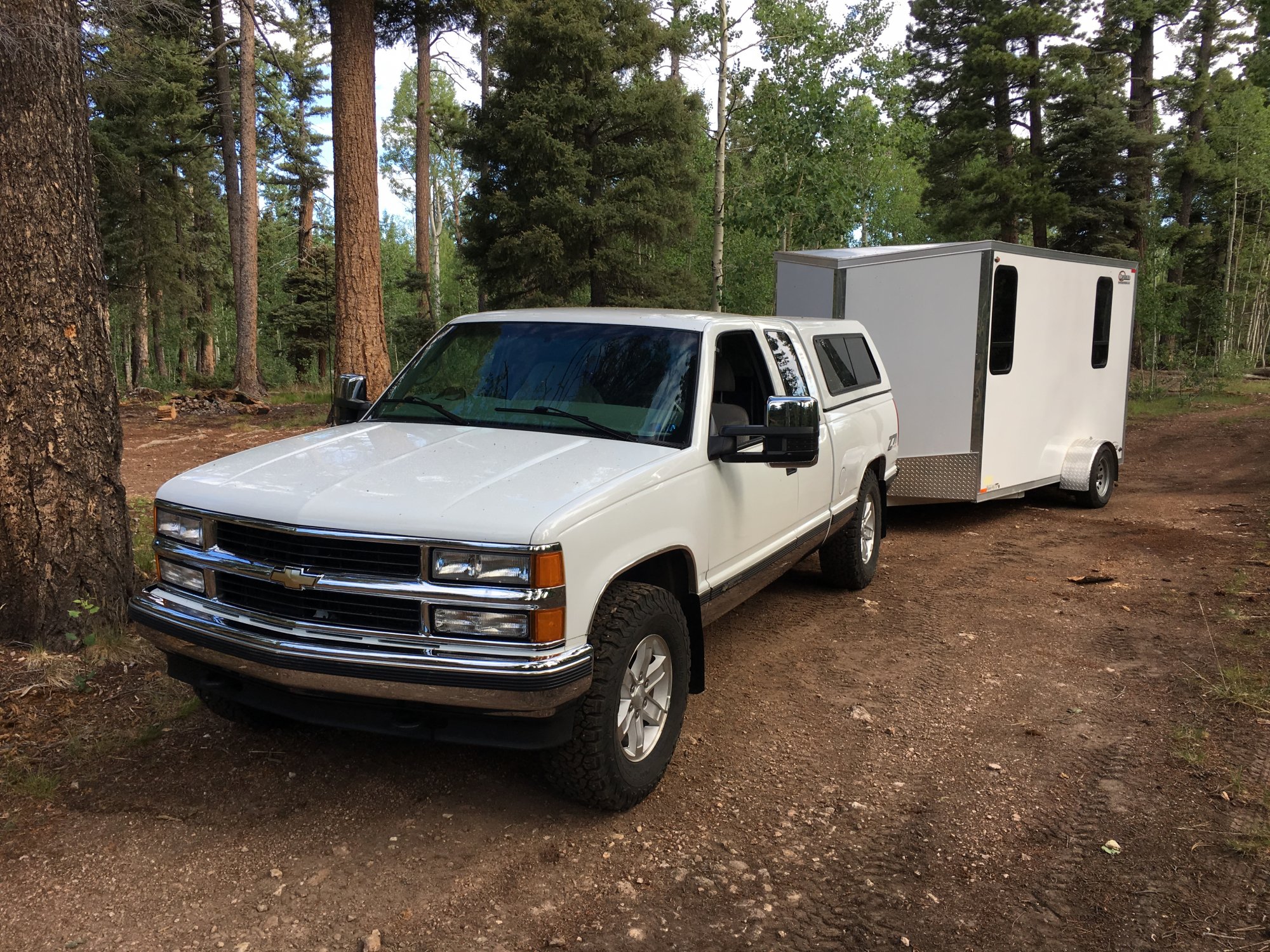

What kinda weight are you pulling behind it?
Prob about 3k - 3500 lbs. a 7x 14 enclosed single axle trailer loaded with camping gear and rzr.
On 10/16/2017 at 7:59 AM, Logan Lanfear said:
That makes me a little hesitant to pull a car hauler loaded to about 6500lbs.  Does that truck have the max tow package?
Yes. It has the F44 semi float 14 bolt rearend, factory trans cooler and factory oversized radiator + 3:73 gears. It was the max tow for k1500 which was 6k or 6.5k lbs.
when it was new pulled a 24’ enclosed snowmobile trailer with 4 sleds, gear, etc. total trailer weight was prob 6k. It pulled it but lots of 2nd gear 5k rpm on hills to hold 60. The trailer fought a lot of wind.
If if you decide to pull with your truck add a trans temp gauge as the 4l60e is the weak point. I’ve done a trans flush at home with valvoline max life full synthetic atf. Trans is original at 205k and counting.
I added a max tow double vision trans temp gauge from Amazon and mounted sensor in pan. Normal towing temp is 185 - 210. Highest I’ve seen is 225 on a long slow 20 mph climb up dirt road where I then pulled over and let it idle and cool down.
