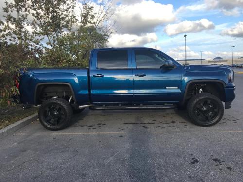

Lifted my Sierra today
I've owned my 2017 Sierra SLE Elevation for 7 months now.
The first thing I did to it was wheels/tires. I bought a set of Rockstar II's and Toyo Open Country AT2's. The tires are 285/55/20.
Soon after that I installed a front level lift and Air Lift 5000 air bags in the rear for when I'm towing and hauling heavy loads in the back.
Next I got 15% tint all around, except for the windshield.
At this point it looked good but I've wanted a real lift.
I pulled the trigger on a BDS 6" lift with the Fox DSC coilovers up front and the Fox 2.0's in the back. Also added to the rear was a BDS add-a-leaf.
All that I read about the BDS coilovers suspension riding better than stock is 100% true and I haven't yet played with the adjustable dampening.
Two things I don't like about it now is it has too much rear rake. Hopefully it's just because the add-a-leaf is new and it'll settle after some driving round with it.
I also realized I had a bit too much air in the airbags so I released some of the pressure and the rear went down maybe 0.5".
Secondly the 285/55/20 tires are way too small in diameter now. I know some of you saw the picture and laughed. Hey, it's only temporary until I get some 35x12.5x20 Toyo AT2's.
Stay tuned as I have a few more mods I want to do.
You could always get a smaller rear block to level it out

I was thinking that as an option but I'll wait a couple of weeks and see how much the spring settles before I do anything. I'll take a measurement of the fender heights tomorrow when it's light outside.

the front will settle too
