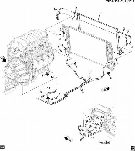

Bigger issue is in the rush of things I didn't research and just a few minutes ago I see a post. From this site no less and now I am conflicted on how to run the lines. looks like the trans lines go into the radiator then the condenser. So I don't have 4 nipples to go into the radiator and the condenser, not a huge deal I can order 2 more so they can all be blown out and caped off. Or do I want to try to come up with adapters to get the lines to go into the condenser?
Also I have to look again but wondering if I have space for the trans cooler under the driver side battery tray down low off the frame rail? I asked some race buddies and there answer is anywhere, But one said inside frame rail on the driver side between frame and trans. Said it may use fan more as it doesn't have air flow but lines are shorter, cleaner install, for service it can be dropped with trans. Exhaust isn't on that side at all so lots of room. I don't like it any farther back then the trans, just in case that driveshaft lets go.  Only down side is the 800cfm Spal fan is loud so ideal spot is far up front.
Grumpy Bear!!!! Any know is the condenser just a single pass one end to another? If so doesn't seem worth it? YES No? Thanks
Your builder suggested this cooler and to bypass the factory system....entirely. I'd go with their advice. Myself, if there is room in front of the radiator. I know it's getting crowded and yes that warms the intercooler air a tad. So choice time. You want bragging rights power, or reliable power? Protection is important and yes you could mount by the trans and IF you never drive in the snow/salt or dirt...…..Anyway, you asked for my thoughts. There they are. I'm giddy!
Ok so the finally call was to bypass all the factory stuff. I only had the 2 nipples so I will order up either 2 more service nipples or just use a tube cuter and cap it off. The cooler is mounted to the frame on a slight angle right where the stock plastic skid plate is. my plate is cut up to clear the turbo pipes and the cooler is between those. it is low nut not scrap the ground low. so it works I would have to tear of the front air dam on a curb and keep going to hit it. So it is good. i will mod the skid plate and reinstall. I need to finish up the wiring harness I added Delphi weather pack plug for easy service and repair, I just went the simple way the instructions said and wire goes to 2nd battery. the thermostat switch controls it.

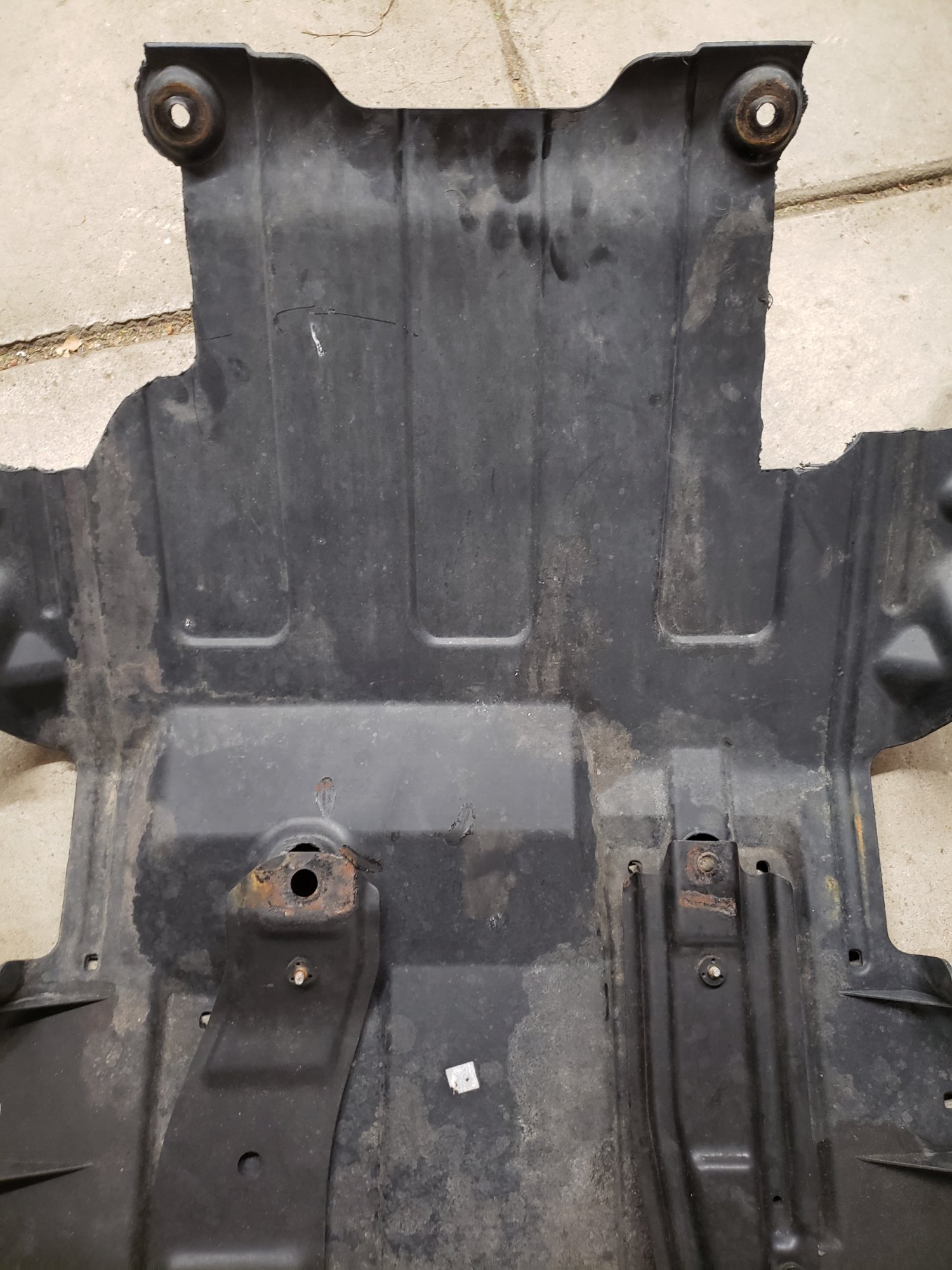

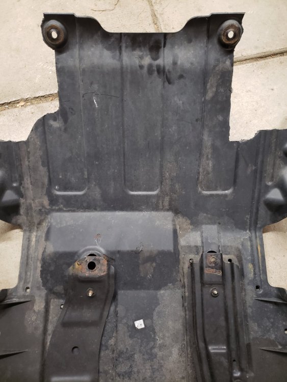

I haven't yet. The cooler is mounted between the large round front tube and the huge front member beam. But the cooler is upside down. The fan is facing the ground. So I will flip it over and lift the lowest side up some 4" so the lines and fittings are over the member and under the crank pulley. Then the skid plate will bolt right back in.
I don't want  to cut a huge square out so was thinking Maybe 1" hole saw. Even thought about buying the 2 piece aluminum slid plate and modify it.
Also looking at the idea of welding in a plate to the drive dive removable support then cut a large circle in plastic for the remote filter mount. Do know yet.

Oh and also the diagram was wrong the trans ONLY goes into the condenser and looks like it is single row.
