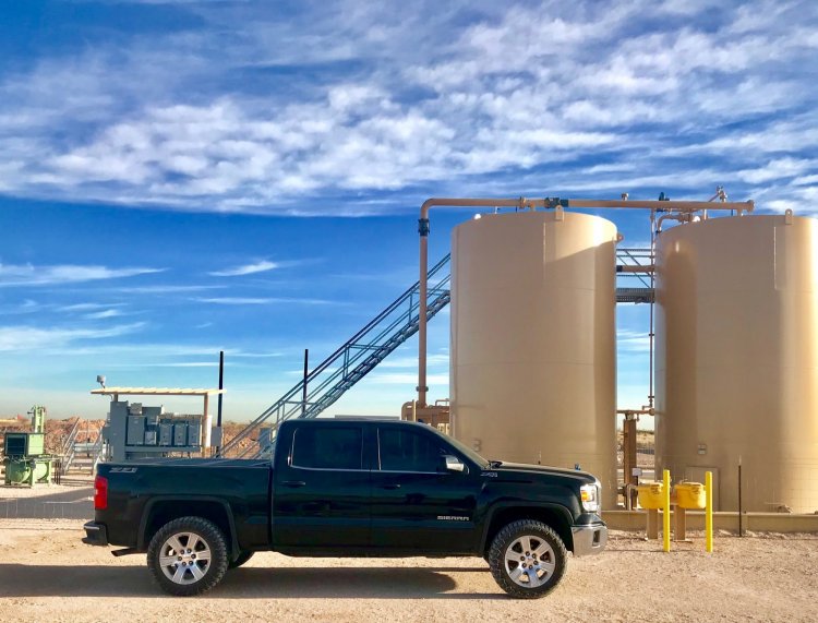

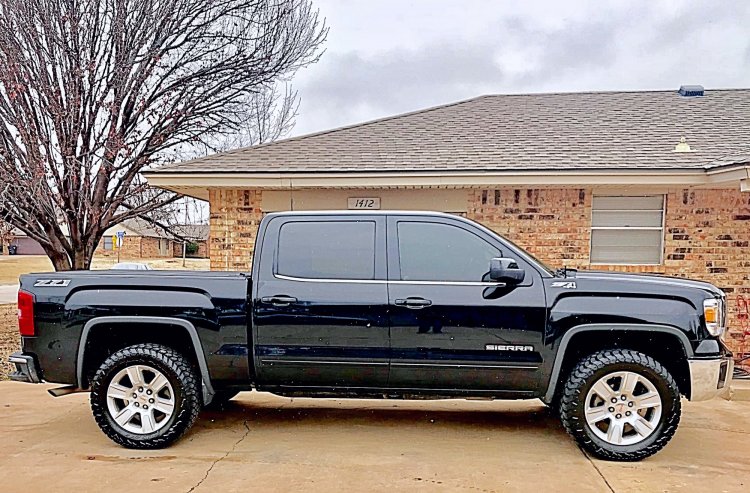

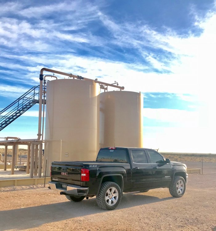

1.85" Bilstein lift in the front and 3" blocks ( removed factory blocks) in the rear. Tires measure 33.1" tall. 9dc878c7e30a0ef8258f7559c07e90a9.jpg
Sent from my SM-N950U using Tapatalk
Didn't realize when I loaded this pic I had around 1000 pounds of shingles in the back lol.
