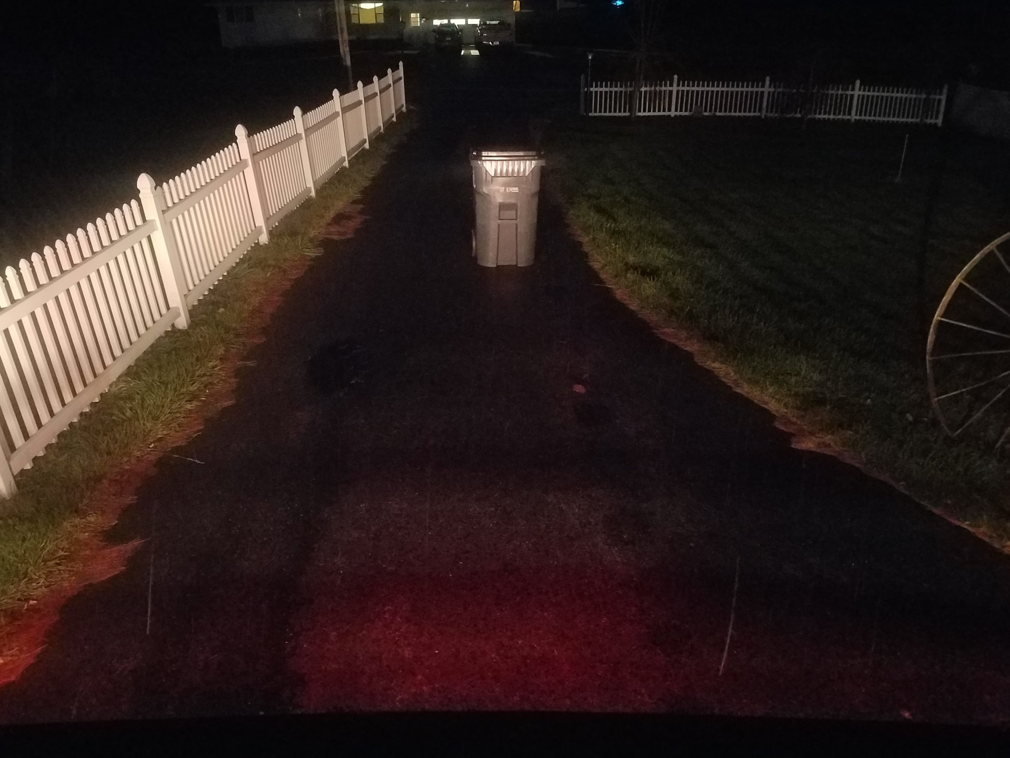

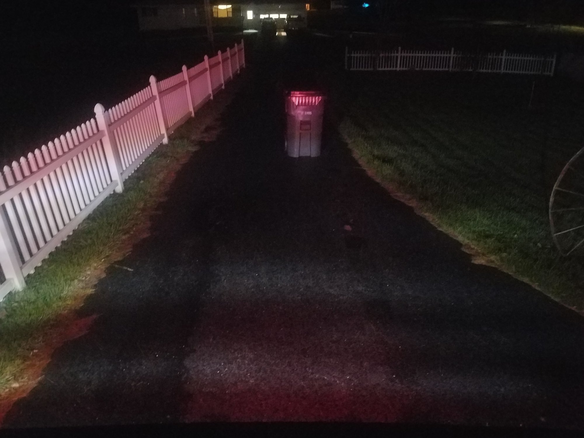

I got Acme RedRocket from theretrofitsource.com and resistors for the tail lights. They are BRIGHT and huge difference between the running and brake functions!
