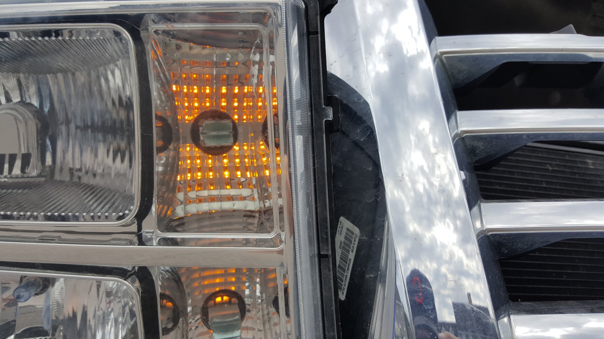

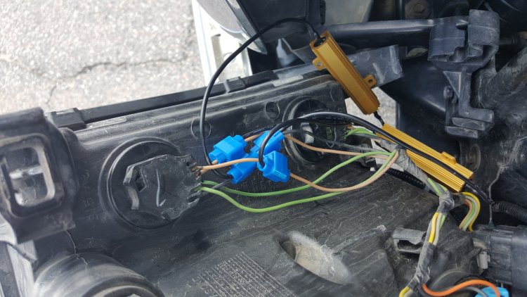

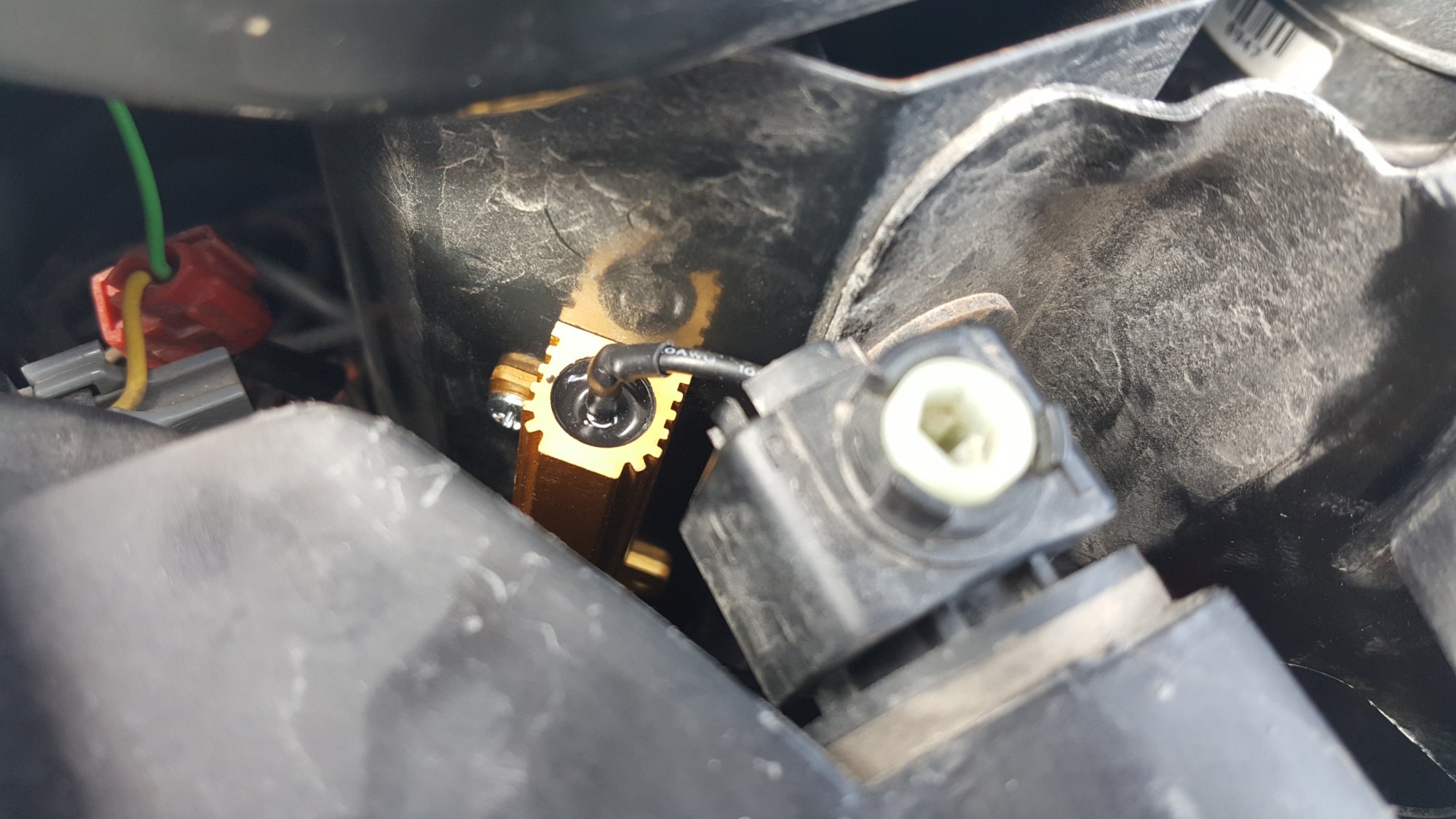

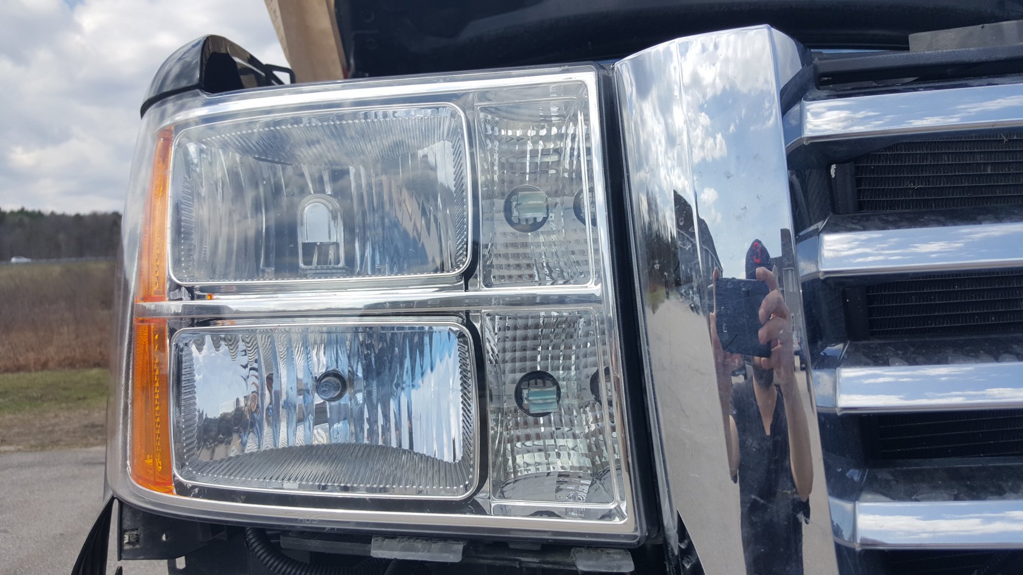

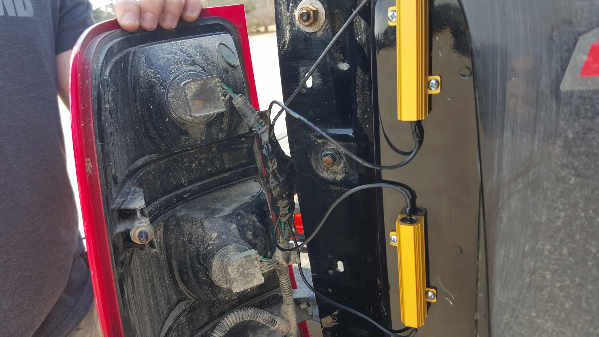

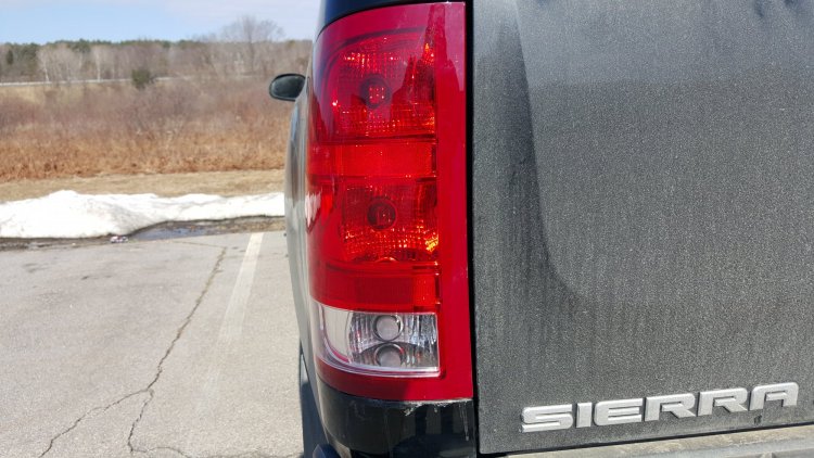

We have gone full LED on Project Sierra using Sylvania ZEVO LED bulbs. Of course, they need resistors. With four turn signals up front and four brake/turn bulbs in the back, that's EIGHT resistors we had to install. It was a PITA but has worked flawlessly since and looks SAF.
Front Turn Signals

Tail Lights
