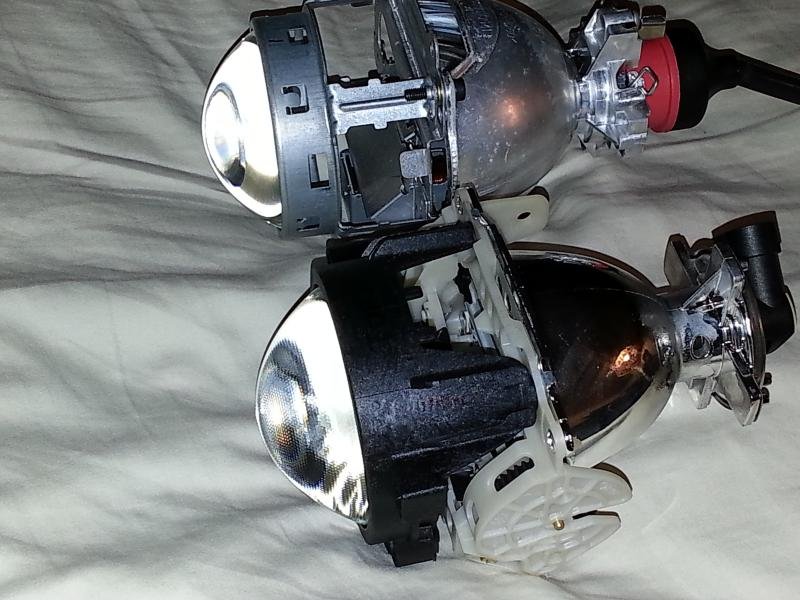

Theses are projectors.  The black one is the 2014-15 Sierra SLT halogen projector.  The other is a OEM Lexus RX-350 HID projector.
Just like to add onto that, halogen projectors are not designed for HIDs. They don't have the correct lens built for the HIDs and you should do a full retrofit before using HIDs. Some have other opinions but I firmly believe you shouldn't use HIDs in halogen projectors.
