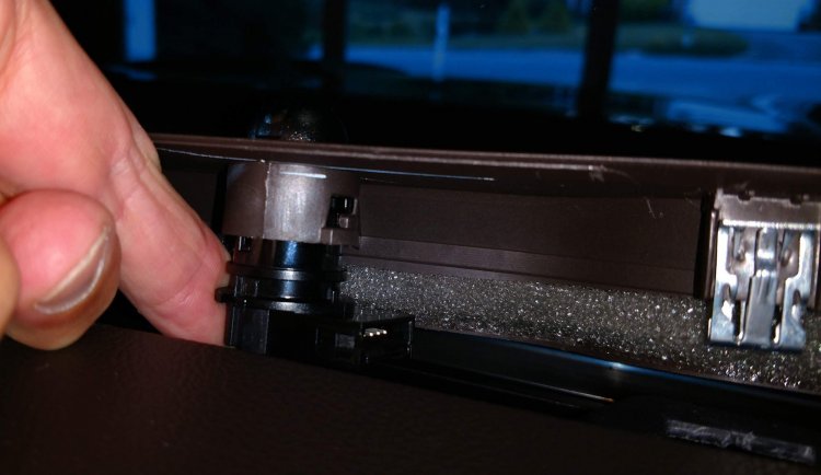

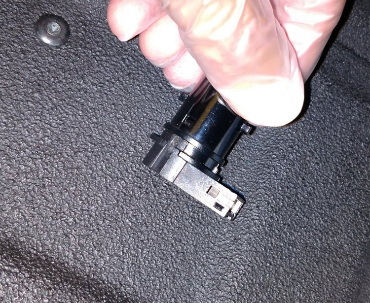

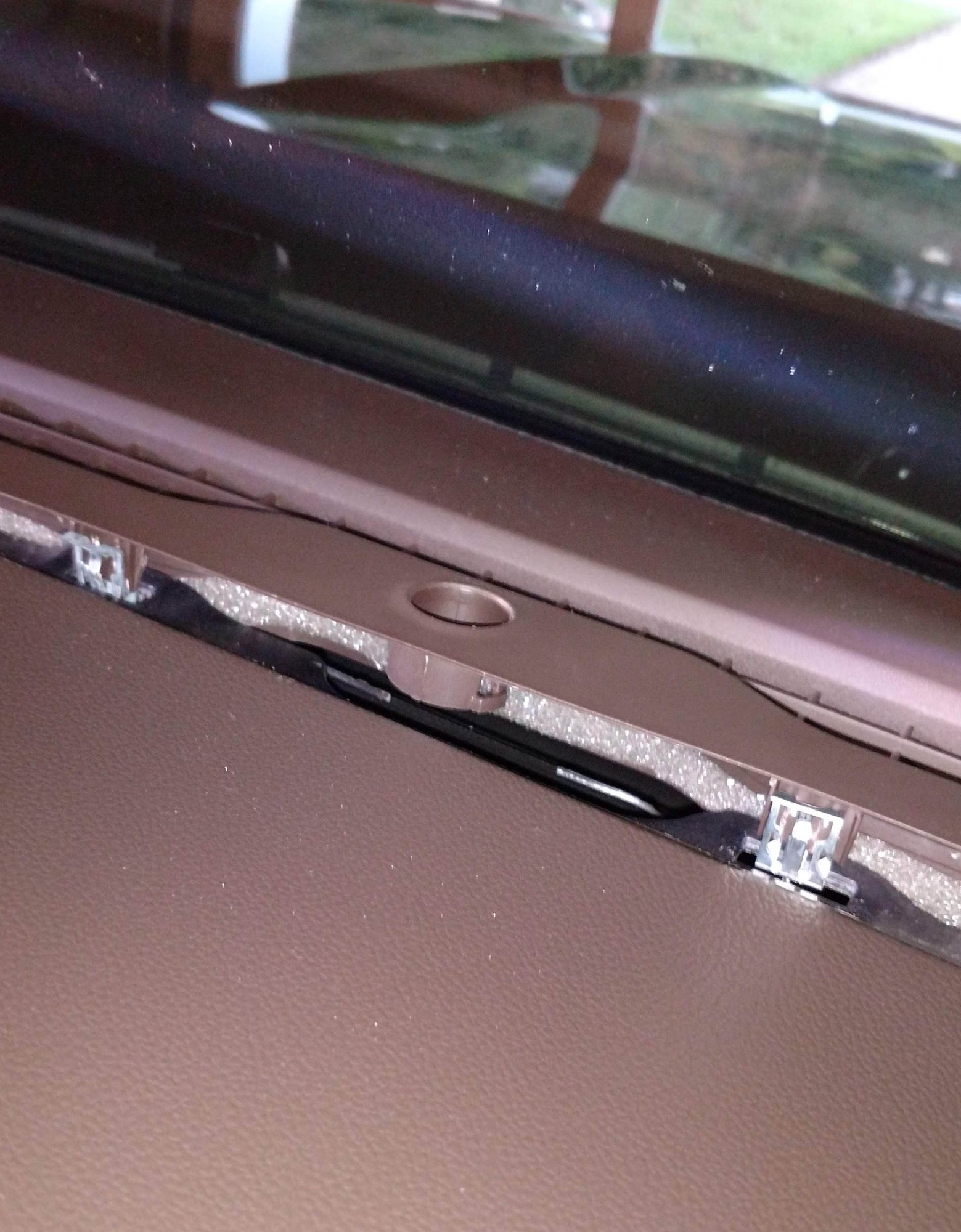

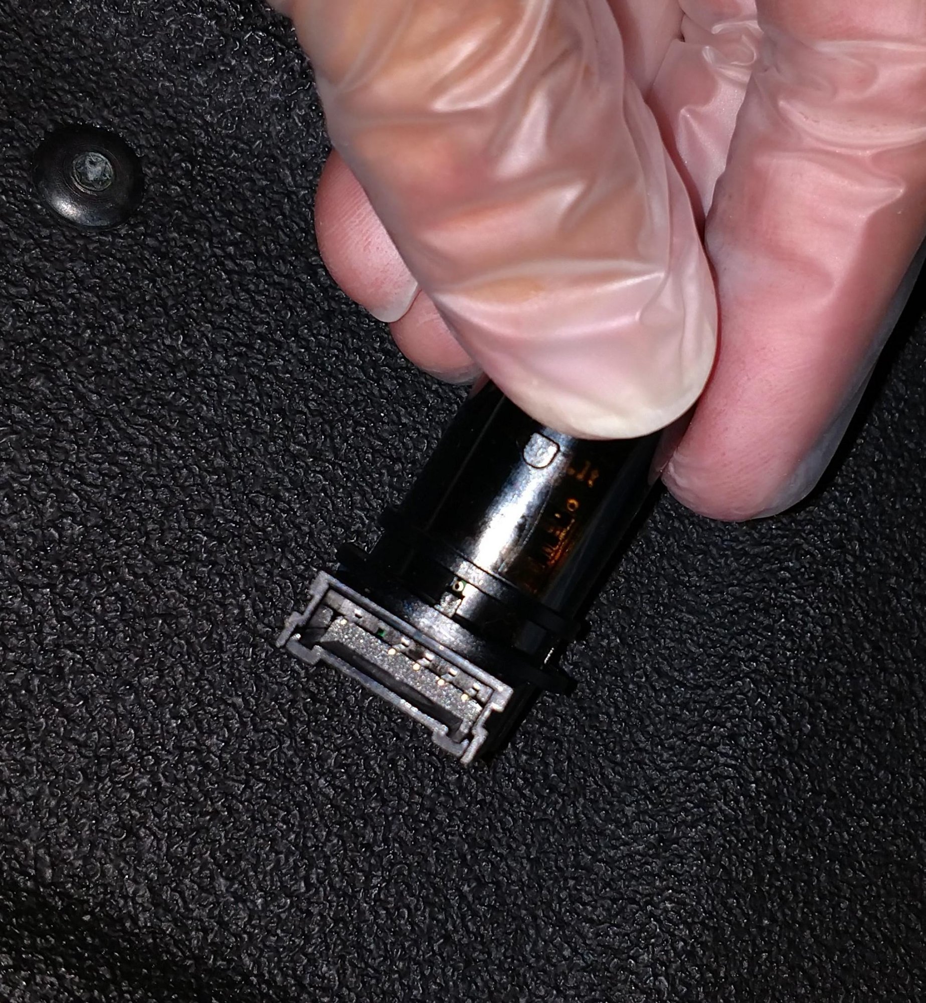

My 2017 GMC Sierra SLT 1500 has the same issue.  Anytime the sunlight is not extremely bright, the headlights comes on.  On my way to work on a normal sunny morning, the lights will cycle on and off several times.  Tonight, I watched the attached video and commenced to remove the white goo from the sensor.  After getting through the process, I decided I should take a few photos and post a comment about the experience.
1.  After removing the bolts from the handle on the passenger side, I found it quite difficult to remove the A-pillar trim.  The clamps on the plastic are very tight, but all you can do is to pull it loose.  There's a metal clamp that grips the trim when it was originally installed.  On mine, the plastic piece of the trim was cut a little by the clamp when it was removed.  I hope it doesn't cause problems down the road.
2.  When removing the speaker trim (next to the windshield), it would be best to lay something wide and sturdy (a thin piece of wood, a spatula, etc.) under the pry tool to prevent the pry tool from denting the dash while prying.  The clamps here are tight as well.  So, it takes a little force to remove the trim piece.  When you reach the sensor, loosen up at least 2 clamps past the sensor.  To get the sensor out, you will have to lift the trim about 2 inches.  This bending on the trim will make it stick up after you re-install it.
3.  After unplugging the cable to the sensor, it can fall down in the dash.  It would be best to tie a string around it or clamp it with a clothes pin to make it more accessible when re-installing the sensor.

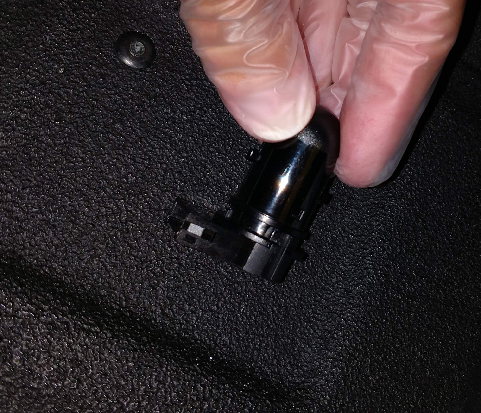

4.  The sensor is twisted to remove it from the trim.

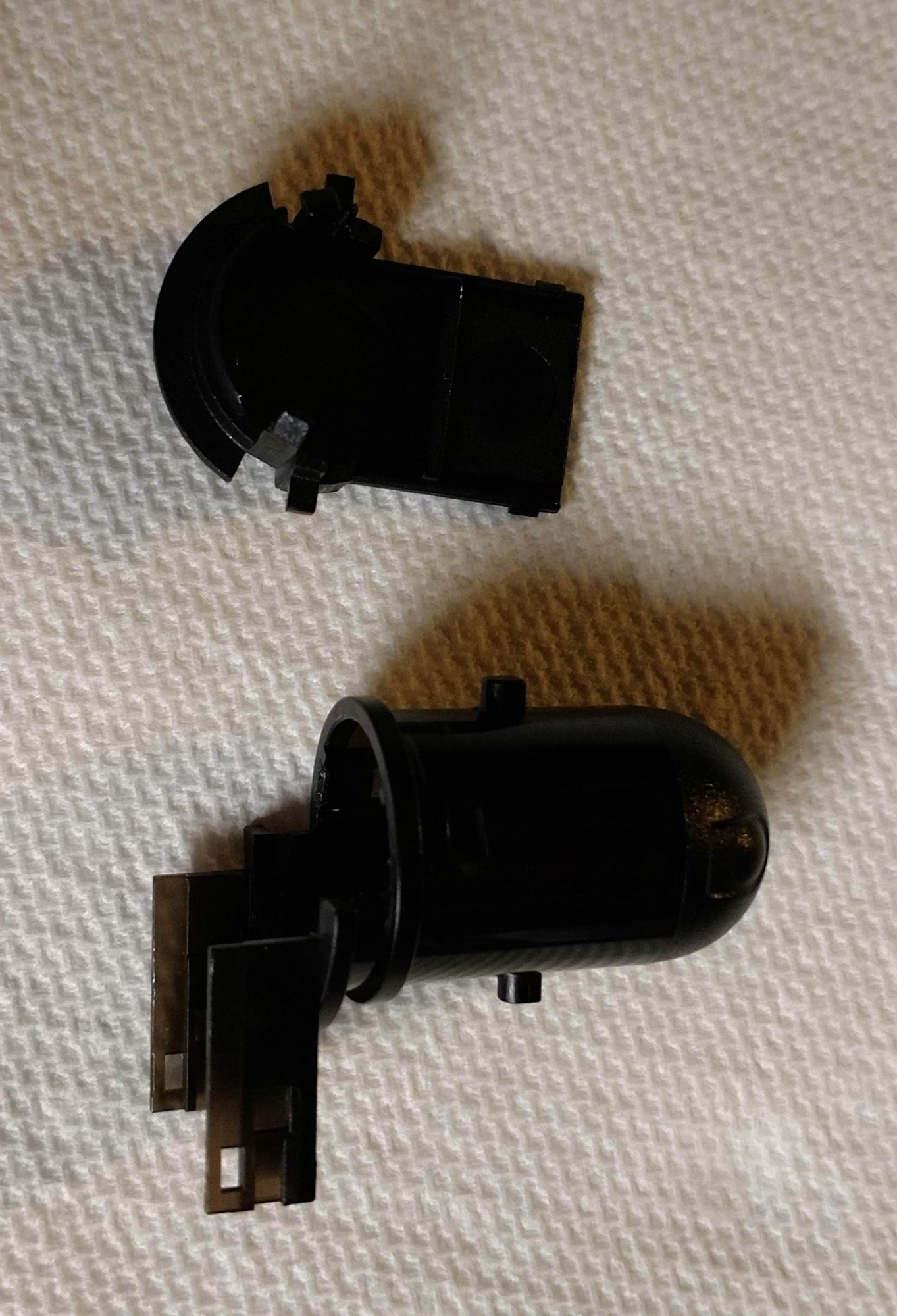

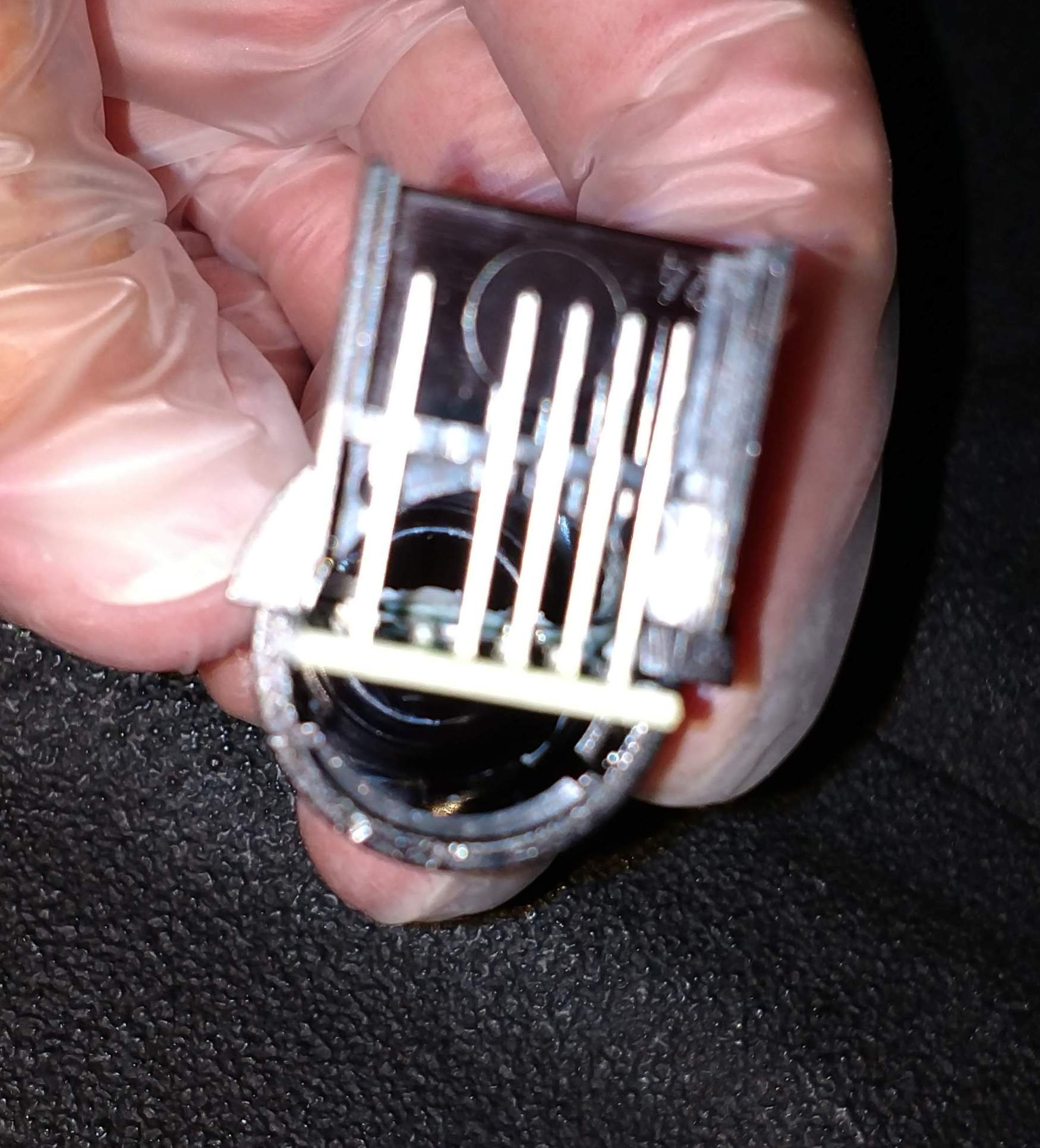

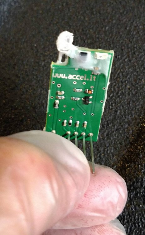

5.  The sensor has four little tabs that keep the two pieces of plastic together. Two are on the sides of the dome, two are on the sides of the plug.  I used two very small flat screwdrivers to hold the 2 on the dome while opening the two on the plug with my fingernails.  It was easy after I got the concept.  But, the tabs would be very easy to break.

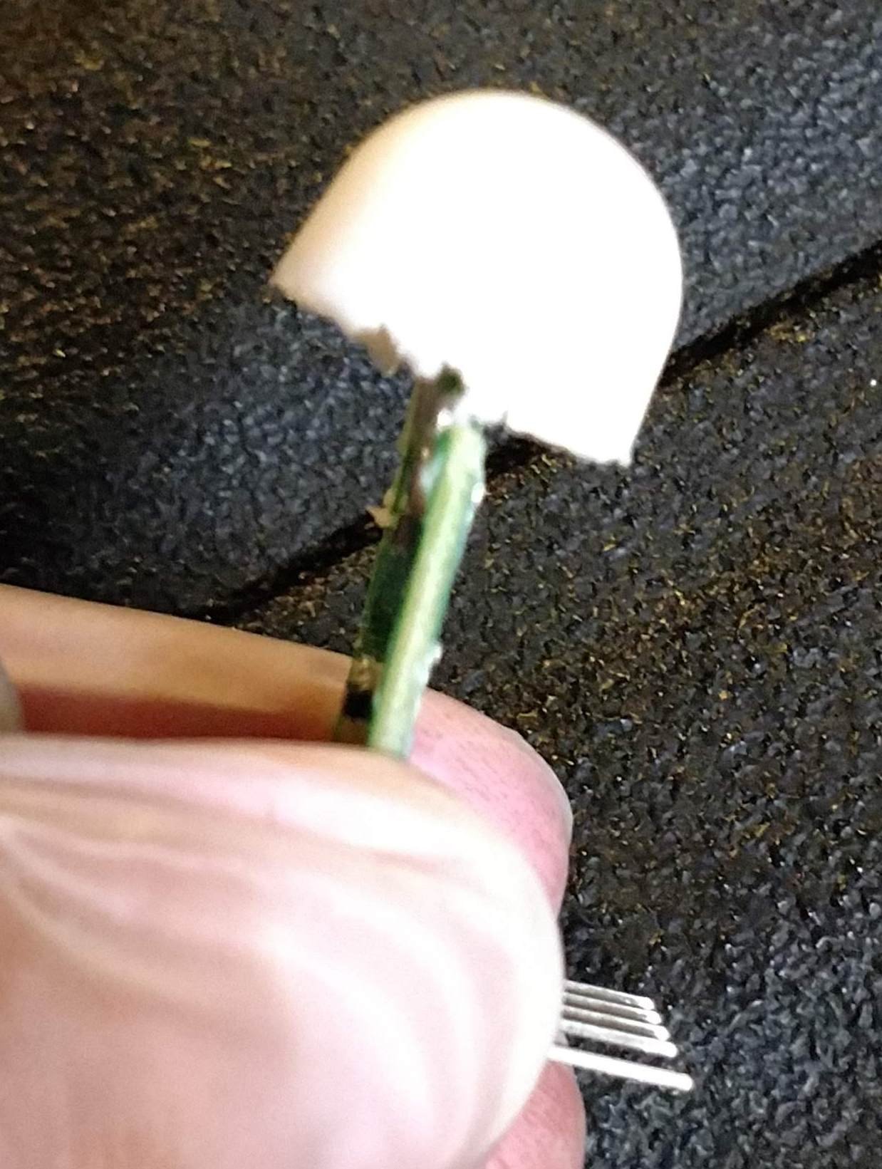

6.  The goop is really like sticky, firm jello.  It was conformed to the shape of the dome and pulled out of the dome with the little circuit board.  I just pulled the dome of goop off the top of the circuit board.  Before and after photos are included.
7.  The reassemble was much easier and took much less time than dis-assembly.  Most of the parts will go only one way, so it is difficult to screw it up.
I finished it tonight after dark. So, the results won't be known until tomorrow.  See the photos attached.  I hope this helps someone out there.
