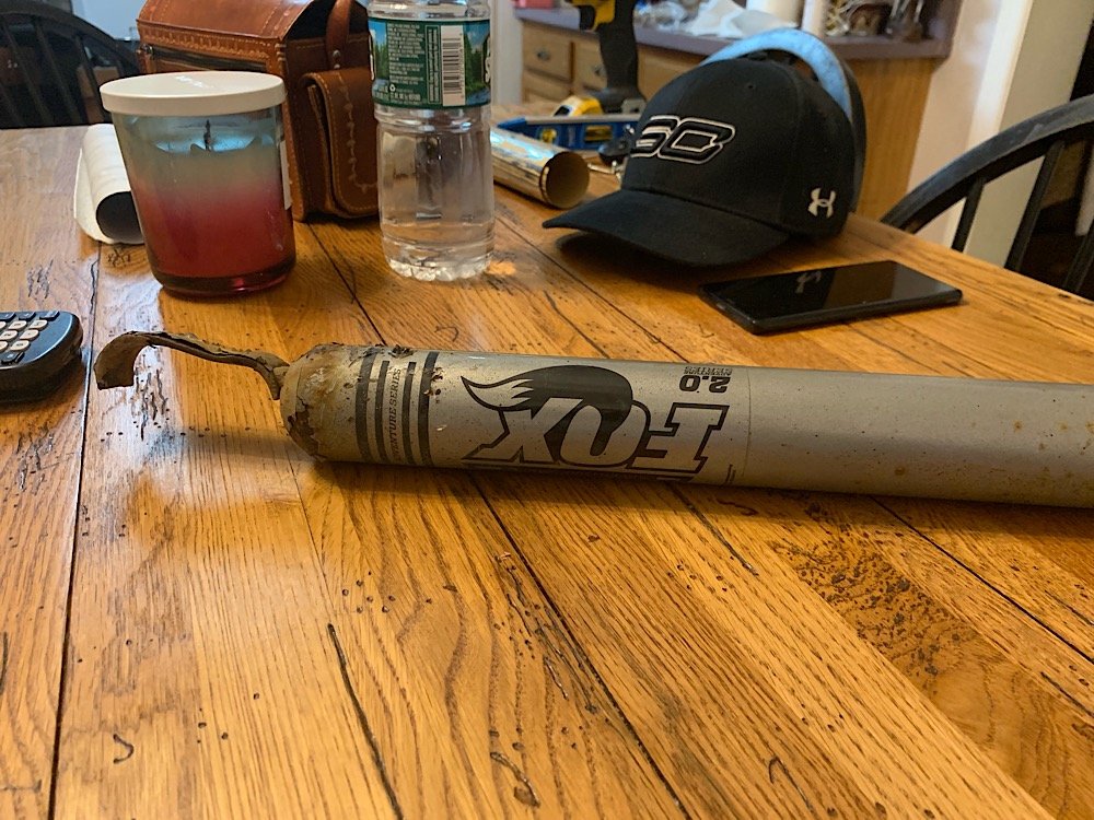

My wife and I were going to pick up an air conditioner my friend had worked on and while traveling I heard a clunky noise. Turns out I had a rear fox shock break. Less than a year and a half. The weld broke on the top bushing. This truck is a road queen so far meaning abuse is not a factor here. Maybe the heavy duty truck and crappy roads here are to blame not sure. I emailed fox. Hope they respond. Not sure what I will do. I do have a clunky noise up front which I thought might be a worn idler or tie rod end which I found recently and have parts to fix it but with this recent development I will have to look closely at the front shocks.
New York yes salt. While the coating was not hearty enough to last very long the weld was broken not rusted apart. When I have time I will post what Fox’s response was.

Fox informed me the shock had been in extreme weather and was past its 1 year warranty which it is not quite a year and a half old so yes it’s past barely. All of there products are subject to extreme conditions by nature obviously. They suggested I buy an aluminum body shock of theirs which probably won’t happen unless they want to prorate a set for a very good price.
      I wrote back and suggested a disclaimer about which of their products could hold up to extreme weather conditions so people wouldn’t choose a shock with poor paint protection like this shock.
          I changed jobs at the end of last summer and have a company vehicle so my HD rarely went out in the extreme weather this winter. It’s a shame because they still have dampening just broken.
