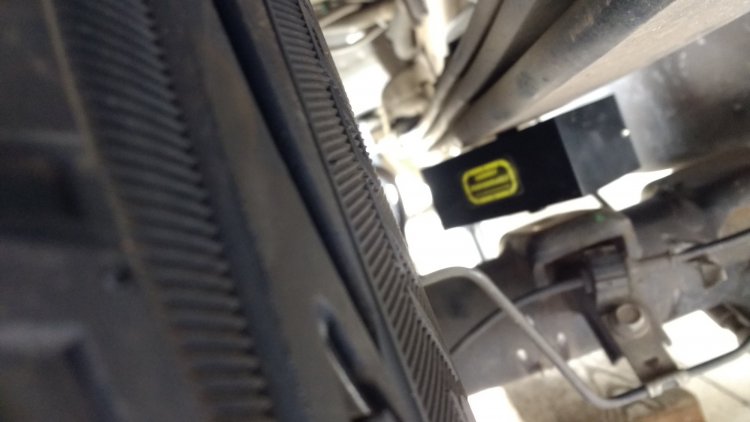

Summit is exactly who I ordered with and the dowel pin hole was too small for the leafspring pin.  I jammed it up in there dangling and took a pic and asked wtf is this?  They had no answer but to ship it back at my expense.

I have that exact pair in the link, they are perfectly flat, no taper, and the dowel is a snug fit.
Performance.  Believe me, I've spent more than I want to admit with Summit Racing.  I know the difference.
After several failed attempts at lowering the jack and seating the block, this pic is of me jamming it up in there by hand and twisting it halfway in leaving it hanging.  That is not a snug fit.  That is a non fit.  I can just imagine pancaking it in to make it seat, and that dowel pin sheering off and spitting the block out at the most inopportune time.  No thank you.
