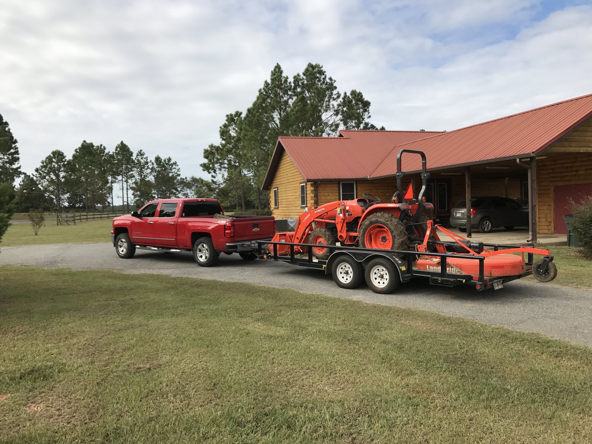

I have LT tires and a add leaf now who knows what that would bump the GVWR up to if any but I guess I will never get the answer I'm looking for until I get everything hooked up I know I can safely tow it because I have done it with a bumper pull I was just wondering about the added weight to the truck I should have the trailer by late march I'll post pics and feedback then
This is what it looked like on the bumper (hitch)
