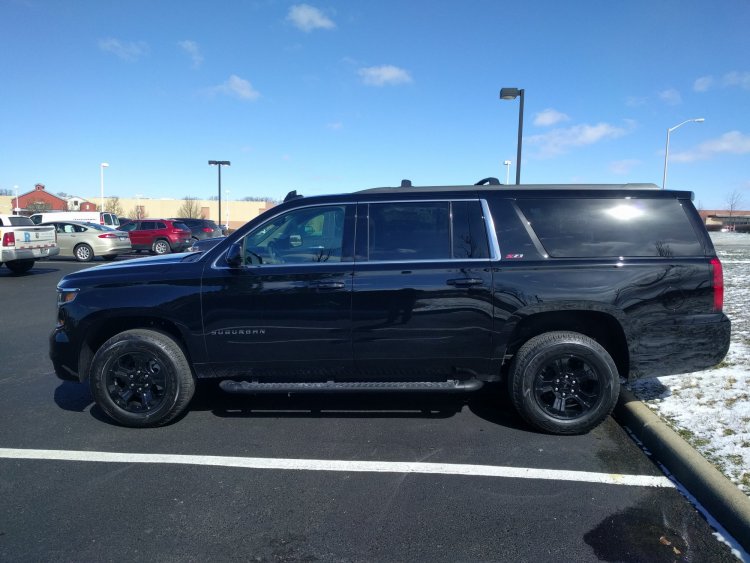

I have a 2017 suburban lt Z71 midnight edition. I have the black 18 in wheels. Swapping them out for a set of 20s. On stock ride height will 275/65/20 rub at all?
You could even go 55's if you wanted to.  I have wheels and tires at stock ride height from the factory, 275/55/20.  Turn radius is better than my cars, no rubbing.
275/55/20 is the stock 20" tire size so that will have zero diameter increase over the 18" and the stock 265/65/18 tires if you are looking for a larger diameter tire.  The 18" and 20" diameter are 31.7-31.9" average, so we will round that to a 32" diameter tire.
I would say at most without a leveling kit, a 275/60/20 should fit (that's a 33" tire).  275/65/20 is a 34" tire and I would think that would rub.  A 285/55/20 may be too wide and might require some wheel liner trimming at full lock, but the diameter is 32.4" so in between the stock 20" and the 275/60/20.
So ideally, 275/60/20 without a lift or level should work.
