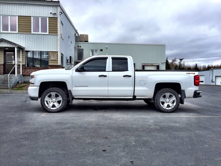

Nice lookin rigs fellas.  The decision actually came easy.  I was walking out from work one day and saw a sign from the heavens (ha ha).  A truck Identical to mine was parked right next to me...only it had stock tires with no level.  Once I saw that, I didn't really see the need to lift it any more than it already is.  I think the 2" RC level is all I'll need.

Look at that sexy rig to the left :)
On 2018-02-16 at 9:57 PM, bcbz71 said:
That's a good looking DC right there.
Thanks buddy.
Stock height 1500's have an appeal of their own.  I like to look at trucks on the lots in my free time.  I am always drawn to the  used unmolested, stock trucks.  I really like the looks of Op's truck but the one on the left would present more initial appeal to me as a prospective buyer!
I'm talking about that van :)
