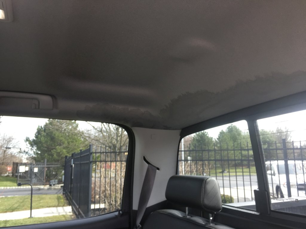

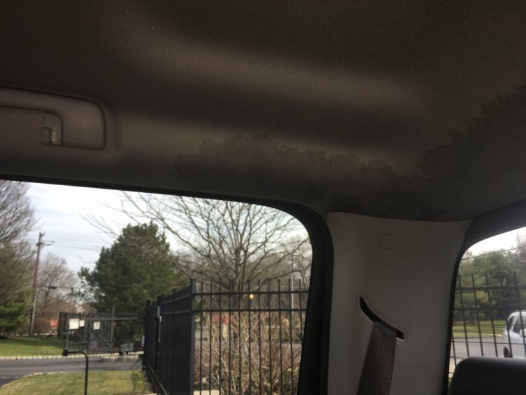

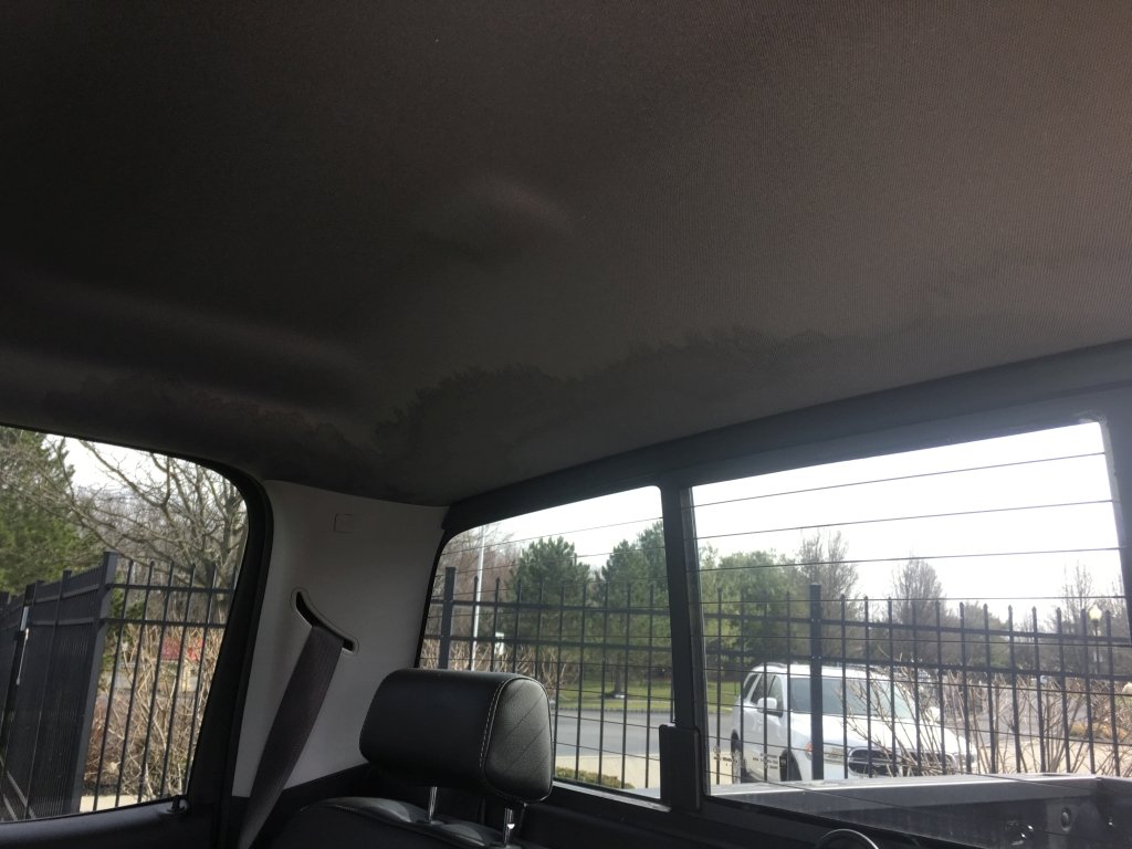

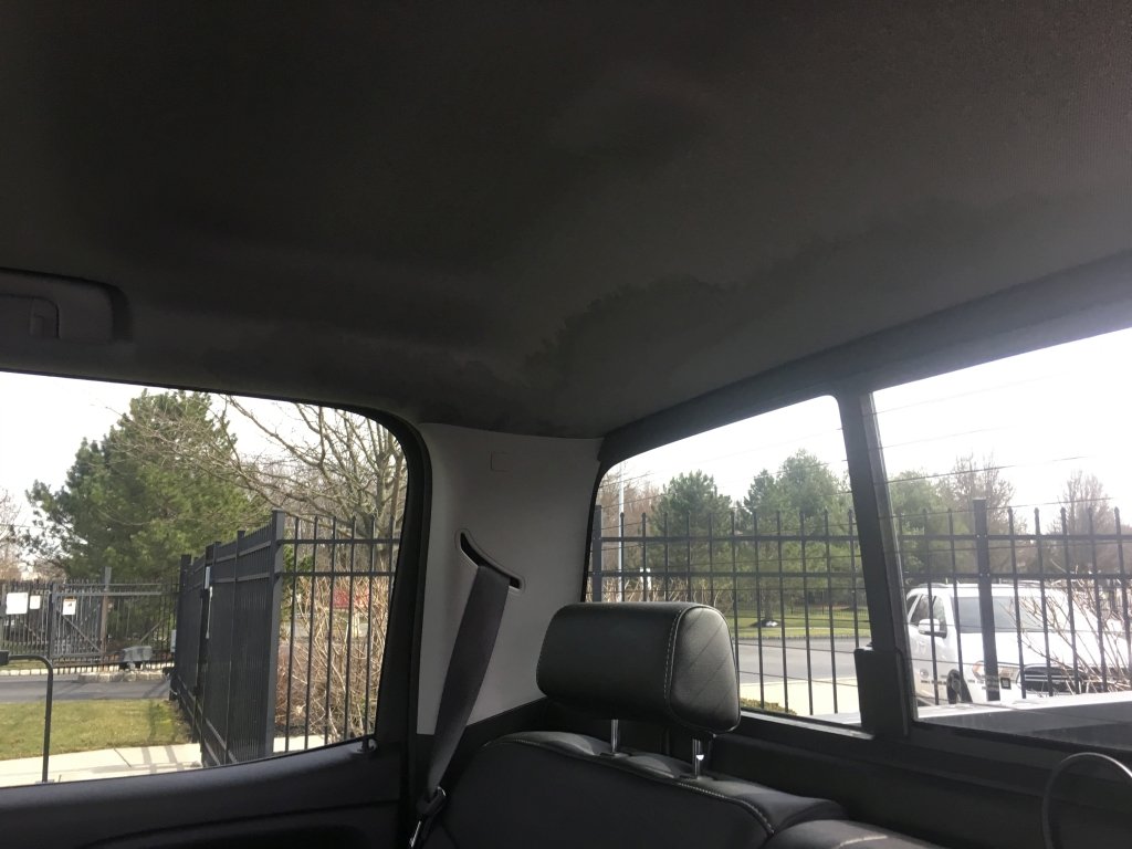

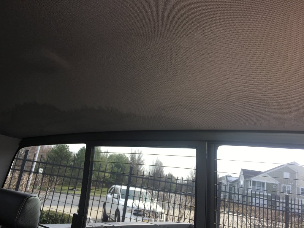

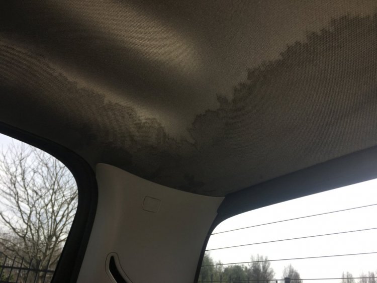

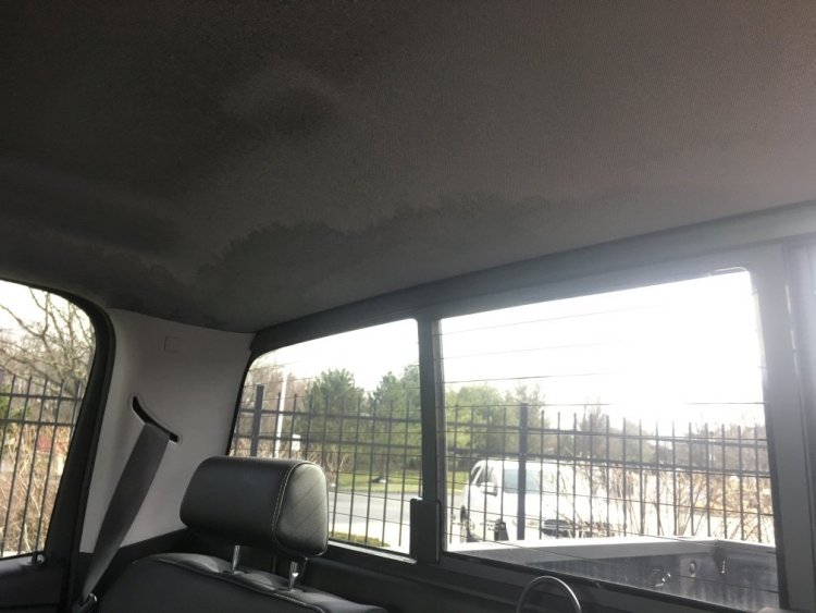

New poster, happy to be here.  I have a 2015 GMC Sierra 1500 Crew Cab SLT.  My wife and I were installing a car seat for our expected new born, and my wife noticed a stain in the headliner, and asked if that was new?  It looks like I have a roof leak of some kind either coming from the back window, or possibly the roof rail?  I've seen other posts about the XM radio antenna not having a good seal, but I haven't seen evidence of leak from the XM Antenna area (driver side headliner, sun visor, etc).  This area is in the rear-right of the cab.
Attached are a few pictures I took just now of the leak, and I was wondering if anyone else has experienced this / what the fix was?  My truck is still under warranty, and I've made an appointment at my local GMC dealer for this week to get it checked out.  My biggest concern is rust / needing a new headliner.  Thoughts?

I’d be all over that third brake light. Done a ton of them for my dealer. Don’t really have to worry about rust if you get it fixed in a timely manner. That metal on the body is treated. The seal on the brake light sucks. Sometimes they just get a little sideways and leak. The carpet behind the seat is probably wet too.

Yes it’s for sure the 3rd brake light! I have a 2016 high country & I just removed mine after seeing the exact water stains you have plus water in the housing. I found a gasket where water has passed through. Instead of waiting on dealer I am repairing myself.

You can find generic weatherstrip at an auto parts store. Cut to fit. If it’s under warranty they’ll replace the whole thing.

@Donstar .. My truck is currently at the dealership.  They are replacing the whole brake light assembly, and since they did not have the parts available, my truck is sitting in the dealership awaiting the part to arrive.  As far as the headliner, I haven't gotten a firm answer on what they were going to do for me.  My GMC dealership here in South Jersey really sucks at customer service / being proactive on making a customer happy.
