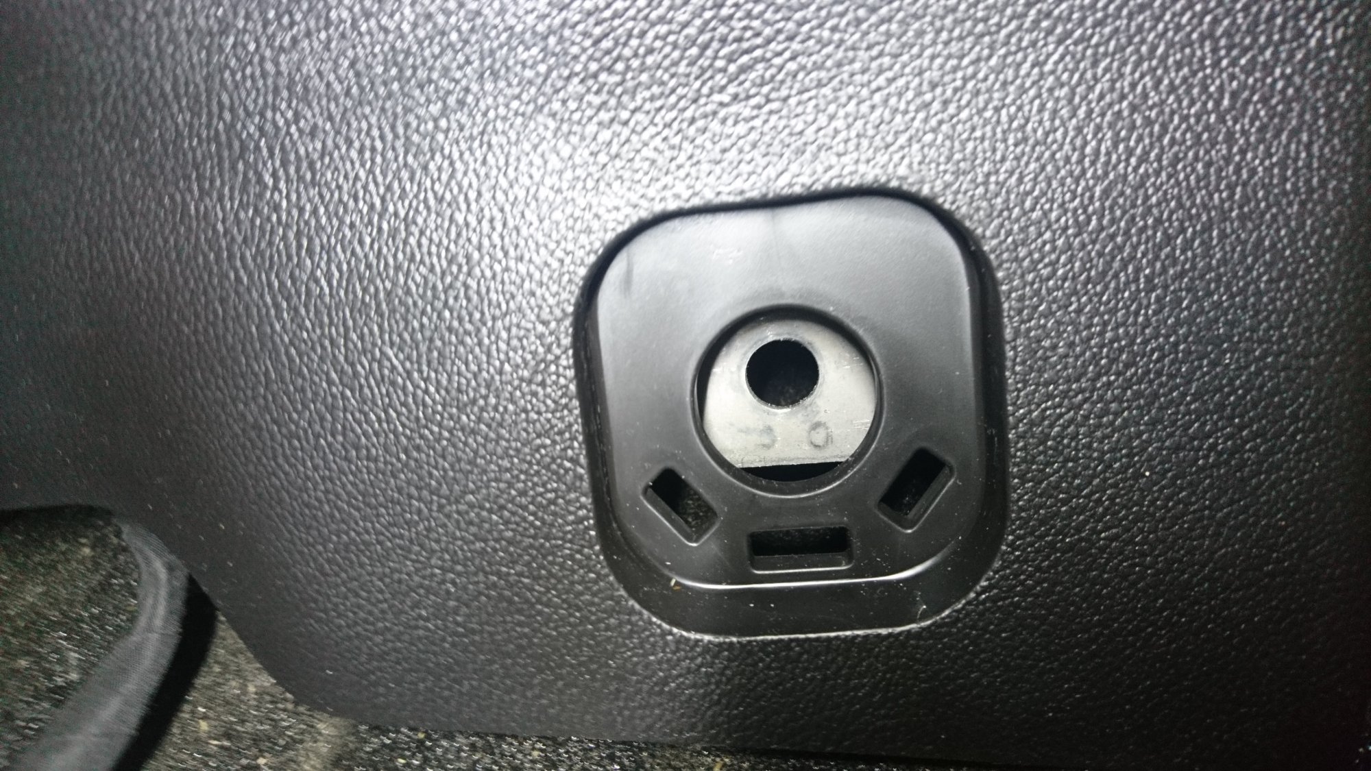

There's two alignment pins that fit into the floor. Slot those alignment holes in the floor and slot the mounting holes in the console itself and it should work for you. I have my carpet out, I'll go take a pic of the alignment holes in the floor.
The alignment holes are the outer holes in the pics, you can see the paint scratched up from me trying to put the console back in before I figured out it had alignment pins. DSC_1184.thumb.JPG.85d60afcf50549ba84a500922e50c054.JPG
And here's one of the bolt holes for the console. The other 4 are the same. I don't know if you'll get two inches out of them, but you might get one. DSC_1185.thumb.JPG.187086023ff7689c4e30b6440d3349c4.JPG
that is exactly what im looking for, gives me some hope i can move it back far enough to make a difference...
Thank you for the insight and pics.. helps me decide to pick a weekend to at least remove the seat and see what can be done..

Are you handy with tools ?   Go buy a piece of 1-1/2" wide 1/4" thick flat steel bar. Determine how far back you need to move the console back and add 2 inches to that measurement. Cut four pieces to that measurement. Mark 1 inch from each end centered in of each of the cut pieces. Drill a hole in one end of each large enough that will allow you use an appropriate size bolt to bolt it to the truck floor. Drill the opposite end of each piece in a size that will allow you to tap that end for the original bolt to be used to fasten the console to the new mounts. Use your imagination to figure out something similar for the pin mounts under the console. It shouldn't be too difficult and will all be hidden when you are finished, unless you move it back so far the floor is exposed in the front of the console.
This is assuming the seat belt is bolted to the floor and not the console. If the seat belts are bolted to the console something similar can be done with some extra work.
Im very handy with tools and metal, used to fabricate 2 jobs back.. Still do from time to time at home for fun.. I think once i get a weekend or day that i can focus on removing the center seat, i can see what will be involved.. it would be nice to be able to just fab up a small extension bracket so that i dont have to mod the actual truck, but i dont mind modding the truck metal if i need to anyway.. so i will def be looking at all options once i remove the seat and see first hand what im dealing with.
