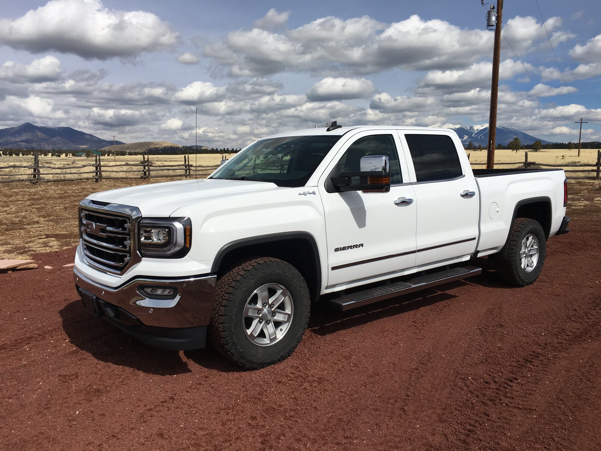

got a 2017 sierra with a 2' level kit... getting new rims and tires and was wondering if anyone had experience with fitments and offsets with these trucks. I bought a 17x8.5 in a -6 Offset. and going to have 285/70/R17 Amp A/T pro Tires on it.My biggest worry is rubbing but I think the tire size is good its just the offset of them rim I may be worried about. Thanks in advance.
I just had same tire size installed but running stock gmt900 wheels. Truck is bone stock and no rub.
Lots of room since these wheels are a bit narrower than the stock wheels. Could parobably go up to 33” tire. I think these come out to 32.7”
Yes, I’m running 285/70/17 on a 17x8.5 with a 0 offset. Could prob fit a 285/75/17.
I also have a 1.5 inch level. Fits great
