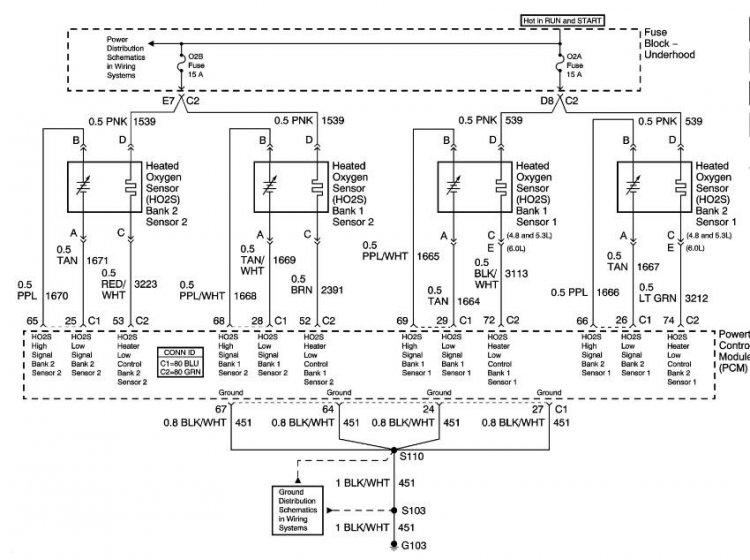

First check your O2 sensor fuses. Then check G103 which is located at the back of the passenger side head.
Here is a Schematic to help you further. Also If the fuse is blown, check all the O2 Sensors for damage.

Thank you very much I will look into this later this week. I will have to research how to read that schematic. When looking at the O2 sensors for damage, you mean physically from like a rock or something, or would there be damage to the portion inside the exhaust? Also is there 4? 1 for each bank pre and post cat.
yes and if you can't read that print, you will have a very tough time doing electrical checks
