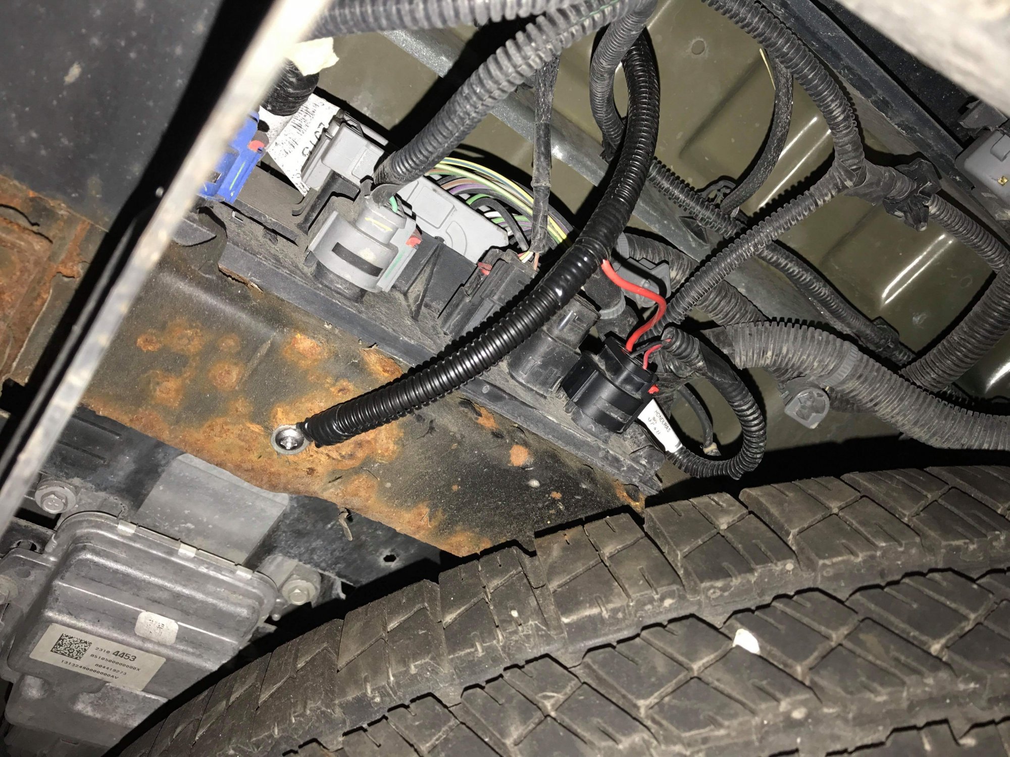

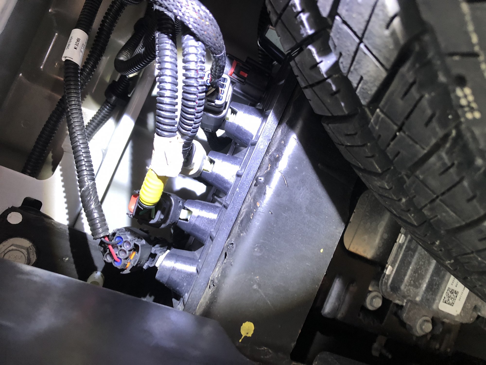

Does anyone know the difference between the pins on a 14 and 18? I purchased a used camper shell and the previous owner fapped up a really nice harness to make everything work, but when I went to plug everything in it appeared his truck's wiring was different from mine. The 1st pic is from my truck and the 2nd is from is. I haven't tried connecting anything yet, but I was thinking I could use the "dummy" plug on my truck (as seen closest to the wheel below). I just don't want to short or blow something out by randomly plugging things in.

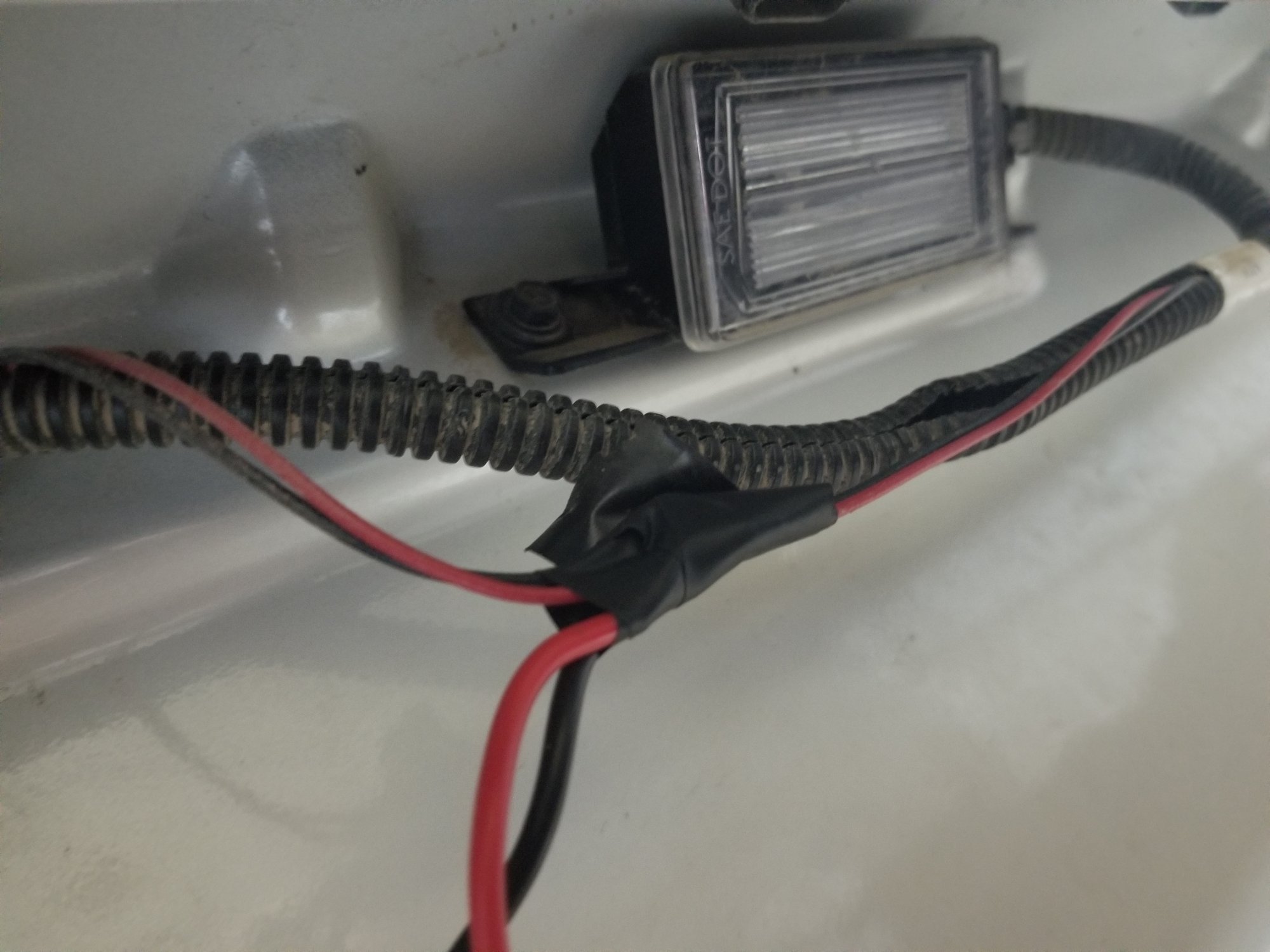

3 hours ago, EpicLT said:
Any pics of your splicing into factory wires? Your truck bed is super bright!
This is it with tape already around it. But all I had to do was expose the wire from the protective casing and splice. Then I taped, and put more protective casing around the new wire to the lights. Super easy with the 201420190125_105349.thumb.jpg.e7d9a68b72c0c90734d41aac6249f862.jpg
