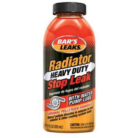

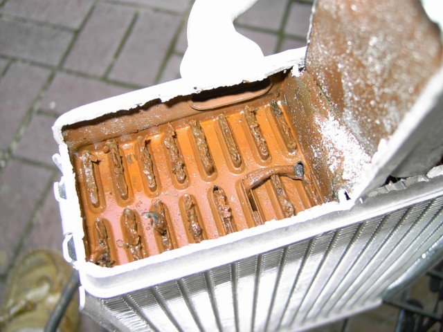

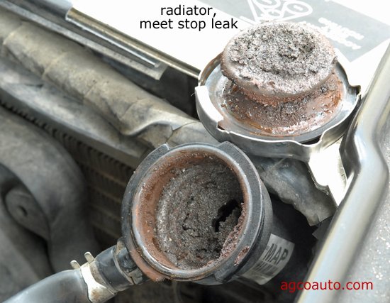

The one I will definitely pass on is Bar's Leaks.
